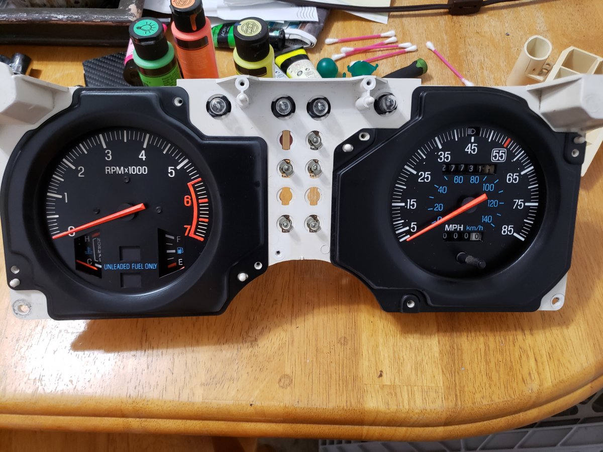

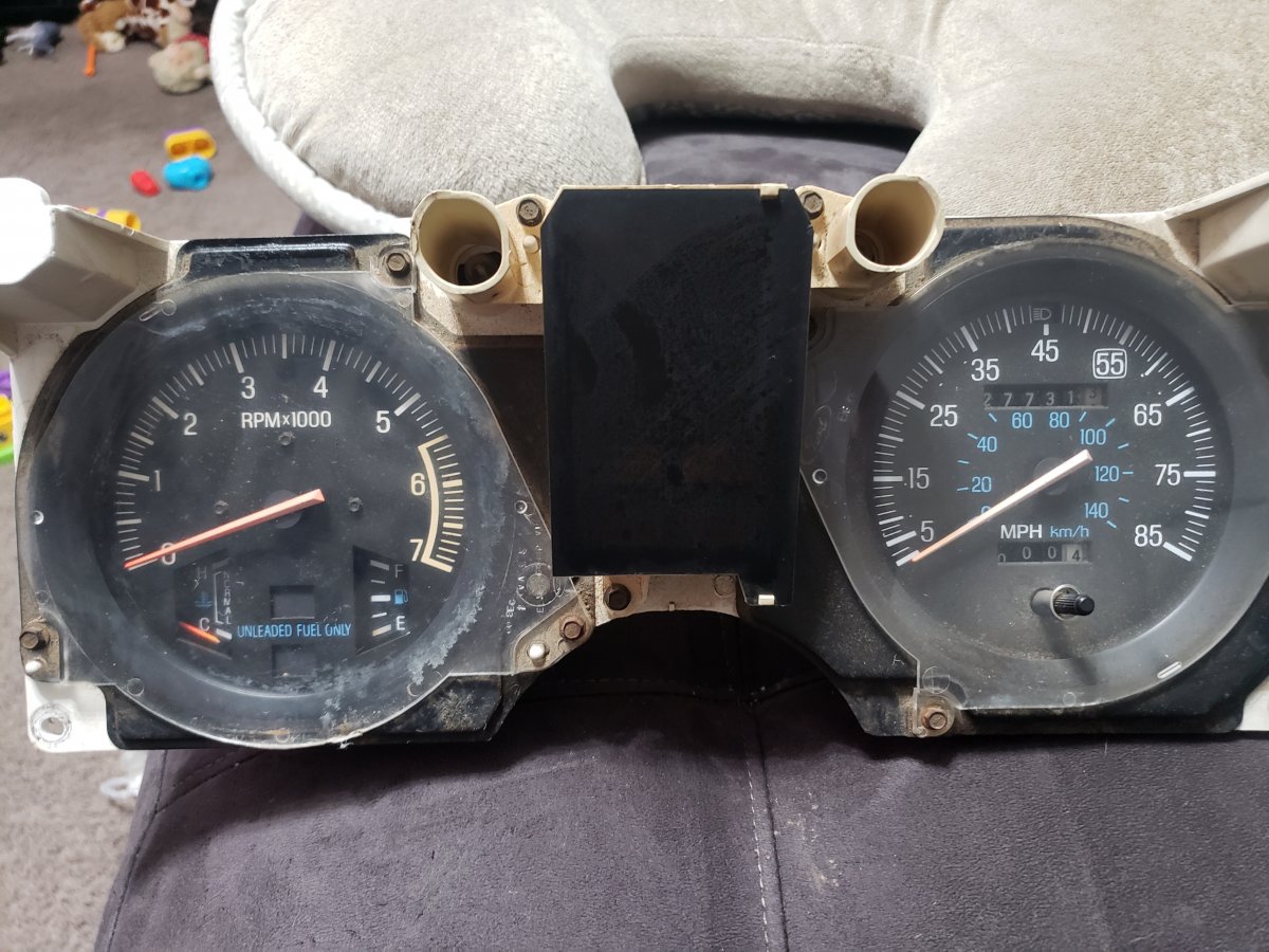

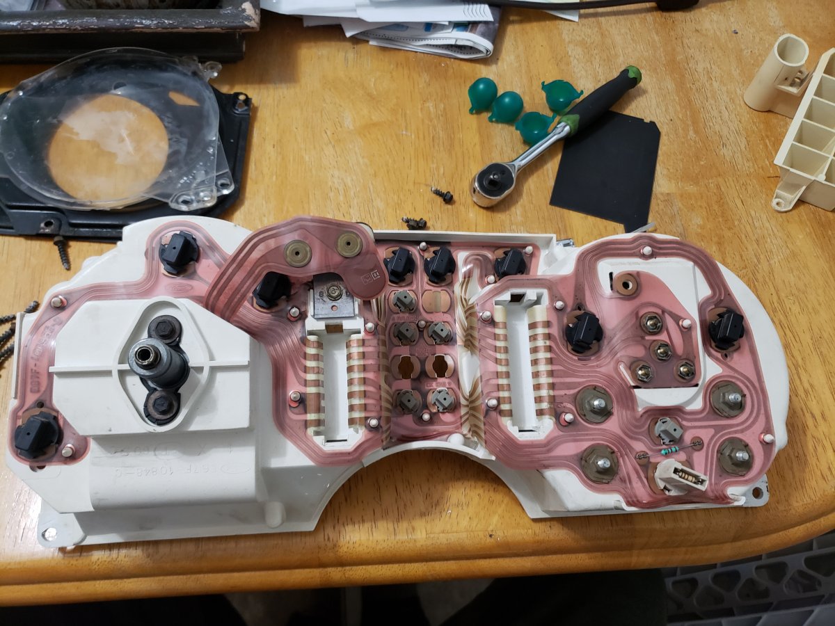

I have decided I do not like painting with a brush. Ripped the dash apart in order to black out trim and make the gauge cluster not look 30 years old. Not finished but already looking better. Still need to clean up my terrible lines and polish the lenses. LEDs coming as well.
Before:

Side note: Does anyone know what pins on the back are power and ground for the lights? Im not sure what color I want to go with yet and would like to check before installing the cluster.

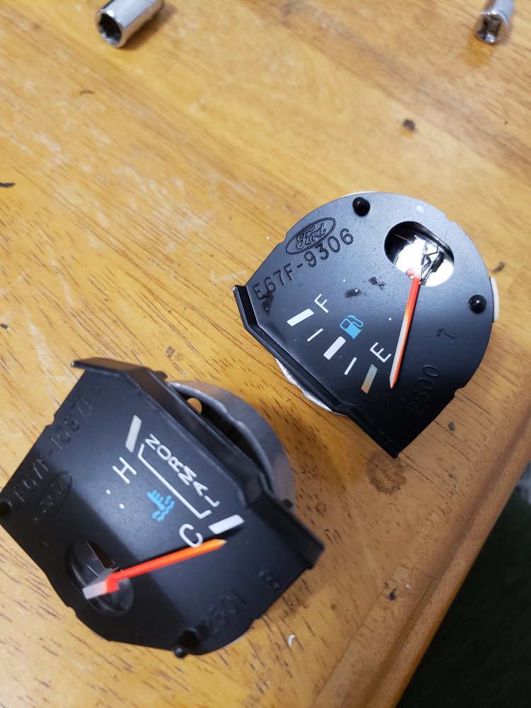

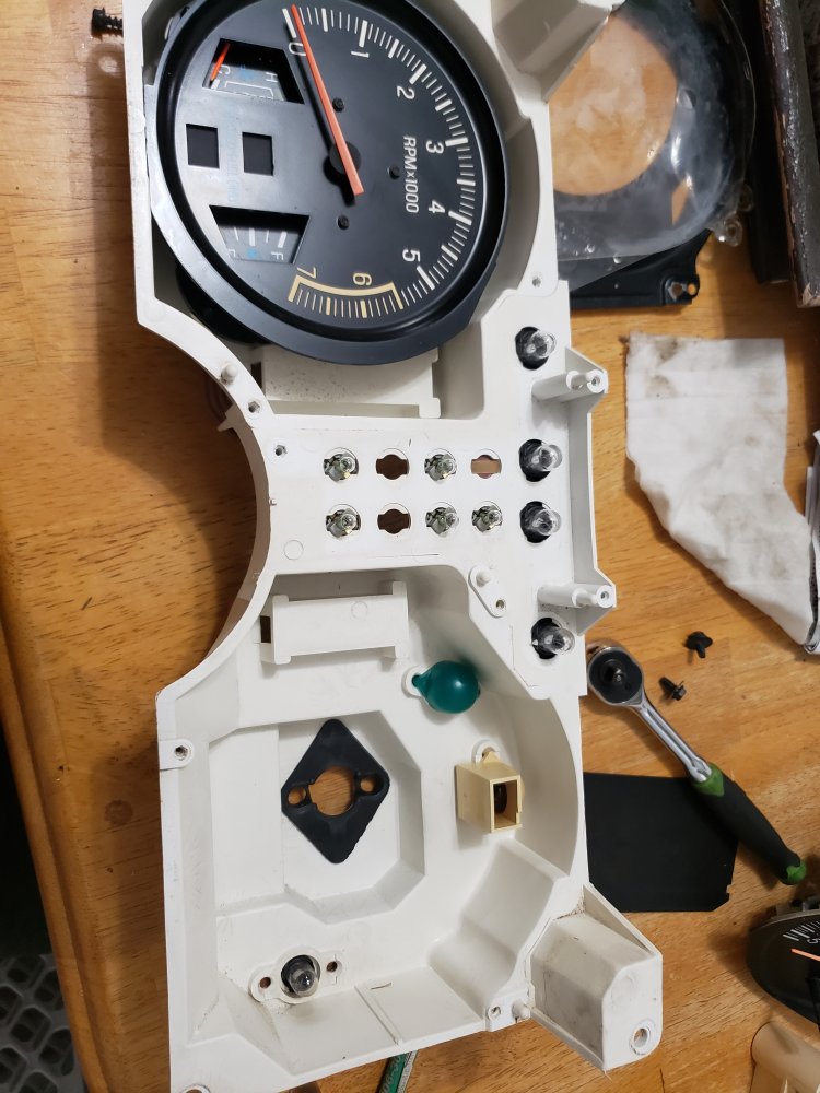

Forgot to post some tear down photos if anyone is interested. I also removed the colored diffusers that give the lights their green tint.

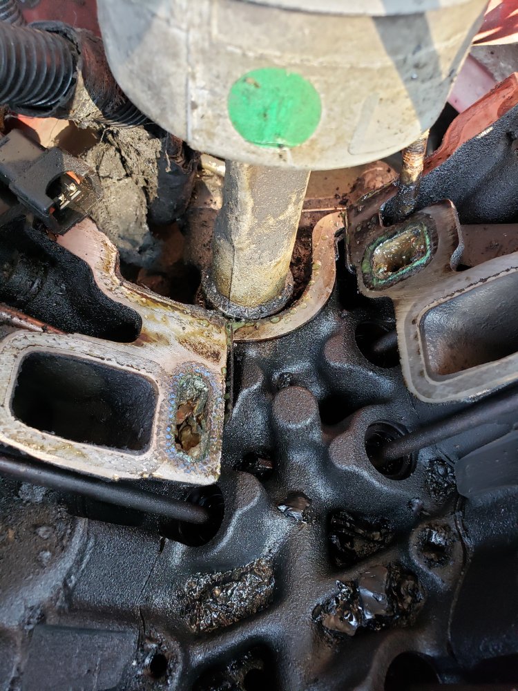

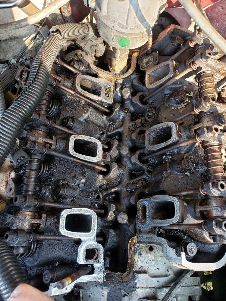

Need to see the rear coolant ports.
You have casting sand.
You want a shot of the coolant ports?
Yes. Need to see what the residues look like. If they have what looks like mud smeared all over them, its casting residues.
Well I'm not home at the moment but they do have mud in them
The residue tends to show worse at the back ports.
If @Ramcharger90 would be so kind as to snap a photo of the ports from my original heads, it gives a clear example on how to see if your engine has residue left in it.
Are you tearing down and having the block hot tanked? If so, be sure to completely clean out the coolant jacket with a pick before sending it out.
