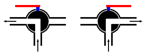

88 with dual tanks, help please....
anything?
just better examples....
3-way
images
2-way

THE issue with using a set of discrete valves relays and switches is that when you flip your manual control you never know for sure that the valves and relays responded correctly.
In my case the factory "valve" is electricro-mechanical
When I flip the switch a small electric motor turns a lead screw
that lead screw drives a "shuttle" that makes the necissary electrical cnnections at the same time it moves the valve step of a double acting tappet valve
It either works correctly or not at all. if EITHER component moves they both move.
the failure mode is no action at all, that'd leave me power less and potentially stranded, but at least not in urgent need of a fire extinguisher...
a seperate valve or relay can fail seperately and you must consider the effects of a discrete failure on other components that DO move as commanded.
There are two kinds of failure mode, a "benign" failure and a malignant failure.
a Benign failure is that the engine dies for lack of fuel the main fuel pump relay is shut off by the PCM and you roll to a stop.
a Malignant failure is a valve doesn't switch but a relay does the fuel keeps pumping and winds up spraying EVERYWHERE where eventually the almighty will provide a source of ignition... And you get a suicide and a viking funeral all at once...

An alternate method that probably won;t blow you to kindome come is to mount a tank in the bed and allow it to gravity feed to the lower tank. this still requires rerouting the vent lines to the in-bed tank and it would probably be a wonderful ideal to regulate this gravity flow with a solenoid valve.
This has less benefit of tere being no way for pressurized fuel from being FORCED into an already full tank...
