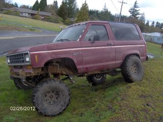

i need to get new fenders but i CANNOT find one of these things that have the same paint as mine, please help if you have em ill buy em. once i get new ones im gonna cut them like this guy did, BADASS!!
remember im gonna take everything off and paint it. this was all just welding it in and all that stuff!!
couple little flexy pics really need to get on some rocks to show you how much this thing flexes!! it really does look like shit with the fenders like they are and everything all rusty and dirty, ill get it cleaned up soon!! anyone have ideas on my windshield trip? just black spray paint maybe? tires are too small to!!

let me know what you guys think. im gonan grab a bite and get to sleep!! positive and negative input is fine. this is my first build that isnt toyota or jeep so i need the info!! thanks guys

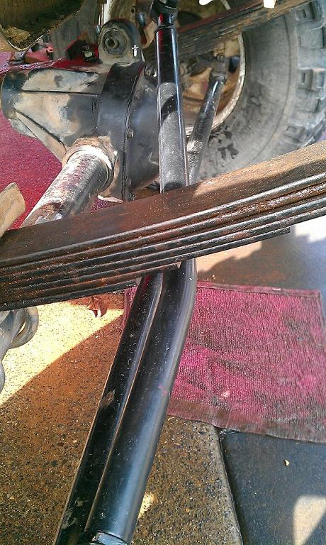

had to bend the steering arm with my tube bender, i think it looks rad haha

Looks like the fenders were cut for a later model bumper. I hope you use gloves more often than in the pics.

I never really use gloves and the fenders were just cut to clear thr tires originally
hope the d35 holds up for you. they have been known to break on the street. IMO the 8.8 rear would have been a stronger better upgrade. but hey, whatever works for you. have you had any problems from the d35? do you always play in mud? or do you actually rock crawl?
that's kinda my plans for a crawler b2. except coils and radius arms up front and using 44/9". i'll never voluntary put a d35 jeep rear axle in something. some people never have problems with them tho... so yeah. hope it works for you.
I've never had problems except the yokes. I play in the mud when my vehicles are beginning bit build them to end up on rocks
And it would be just to much to do the 8.8 and then buy gears. Gotta remember I'm still a teen lol
