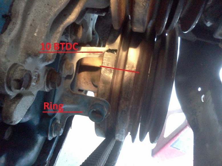

Ok, made progress today. Fuel pressure test ok, hovers around 40psi key on and while cranking. All 6 injectors flashed the noid lite. New coolant sensor, neutral sense switch jumpered. Cleared stored codes, tried to start again, no codes. Have spark, still not running, timing set while cranking as per Haynes manual. (Shorting bar removed,10 degrees BTDC) Runs briefly and only on starting fluid, not on it's own.
Believe I have the correct timing marks on the pulley. There is a pointer and a ring a inch or so counterclockwise from the TDC. See photo. Pointer on 10BTDC, red line is TDC. Pointer and ring are on both motors.

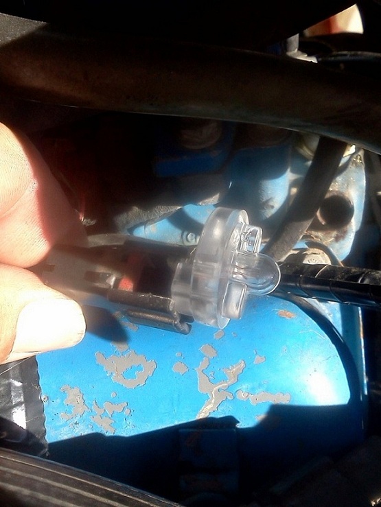

How do you do the noid light? Can each injector plug be undone one at a time or have to pull upper intake and fuel rail 6 times?
Each injector individually, no need to unbolt anything, Disconnect wire from injector, plug in Noid, crank motor. Look for lite to flash. Can't attach pictire from my phone, will later.

Another day and still have a non running motor. Swapped injectors, no click when 12v applied to ones installed. Installed old injectors and rail, but kept pressure regulator. Attached to fuel line to old rail brfore I installed them and all 6 sprayed when 12v was applied. Coil tested good at local Autozone, my coil had the same readings when a new coil was brought out and tested as well. Kinda fires for a second every other rotation, every time #1 cyl is at TDC it seems. Timing unchanged, 10 degrees BTDC, checked with lite while cranking. Removed spark plug, dry and had spark. Starting fluid seems to have little effect this time around. No codes. Dumbfounded.
