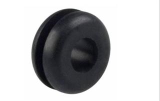

My TK5 was hard to shift when cold, in the winter. Maybe I should have used Mercon. Yea, the stereo you had might have been used in a lower model Ranger, with only two dash speakers. Also, what I did on my 87 Ranger, is I put washers behind the mounting screws of the stereo, climate control and gauge cluster so the it came up to the dash bezel, leaving no gap. I also put a rubber grommet similar to this - http://www.ronlexrubber.com/uploadpic/20111181243571.jpg around the trip odometer button and foam rubber weather stripping and tape around the lense openings to stop dust from getting in. If you do that, just remember to keep it far back enough so that it's not visible when the dash is back together. I also modified the placement of the idiot lights lense, because it was crooked on mine.
