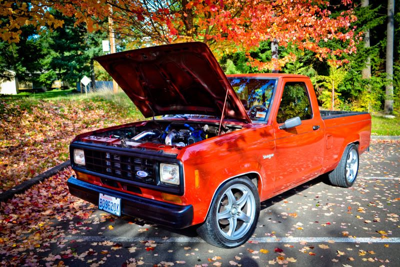

Looks good but looks like it's running rich as hell.
she's running rich at idle, freeway cruising is at 13.5-14.4 and under full boost at 5500rpm its at 11.5-12, which according to my friend who builds 500hp 1jzs you want it rich when the computer goes closed loop under full boost at wot
Under boost sounds good, I shoot for 12 as I hit boost and drop it to 11.5 after a few PSI. That's a little rich at cruise though.
i know I'm just kinda holding out until i can afford the standalone system...the turbo computer works well but its from an auto so its actually detuned 40hp from a manual computer...so there are HUGE hp gains to be had when i get a full custom tune running. plus better rich then lean!
