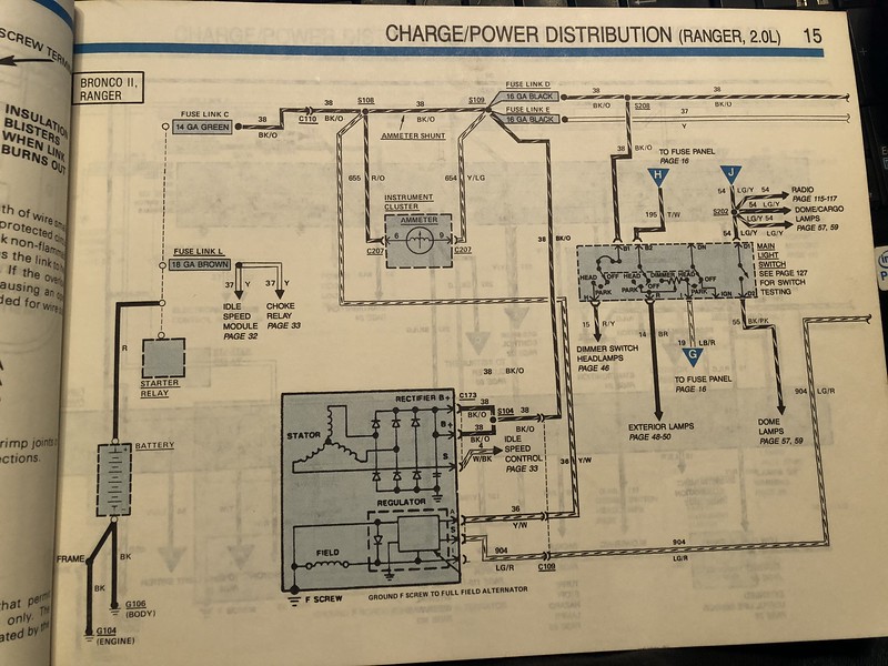

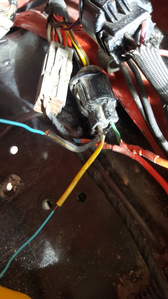

I don't currently have either the bk/o wire or the y/w wire coming from connector c109 hooked to anything, though I did try a few times before.
From c109 it looks like I need the y/w wire hooked to the battery + and the bk/o wire hooked to the alternator but im not sure which wire on the alternator. It's a stock 92 Thunderbird alternator.
It's looking like the "A" terminal on the alternator will be used?

AMP gauge wires are added to the B+ wire, i.e. B+ alternator to battery wire, to monitor direction of voltage on that wire, from Alt to battery is Charge, from battery to Alt is Discharge
From your diagram looks like you need to find the red/orange wire and yellow/light green wire if you want to hook up your AMP meter
These wouldn't be part of a 3rd party wiring harness

I've looked over this EVTM diagram until I was blue in the face, and tried a few combinations of testing, but my testing wires may be too small. The alternator is still charging the battery. I know that much for sure. Confirmed via voltmeter.

It has no wires connected in the cab, both should be out in the engine bay

So far I been driving it for a couple years with just the following: I have the BK/O wire from C110 (C110 is a single wire connector) coming from the cab hooked directly to the positive terminal on the starter solenoid. That's also where I have the large charge wire coming from my alternator to charge the battery.

Wiring kit looks OK but larger red wire replaces Black/Orange wire as the B+ wire
So there should be no black/orange wire unless you didn't use the large Red wire
And there should be a fusible link between starter solenoid(relay) and the black/orange(red) wire
Find the AMP meter wires, red/orange wire and yellow/light green wire
Oh, and look for a Black/blue stripe wire while your at it, that's for Temp gauge, any Ford temp sender will work, just may not have same connector
It's my understanding that the R/O and Y/LG are behind the dash. I should be able to make the connections under the hood without getting behind the cluster at all. The BK/O and Y/W are both under the hood on the drivers side inner fender, and I don't have them hooked to anything currently. I do have the BK/O FROM C110 hooked directly to the + at the starter solenoid, but in connector C109, I'm not using either BK/O or Y/W wires.
So, according to the diagram above, I've got the battery side (left side of diagram) of the circuit connected since the BK/O from C110 (single wire connector) is hooked directly to the solenoid.
It's the middle/right side of the diagram that I'm lacking I think.
It seems like I need to hook the Y/W wire from the cab connector C109 to the alternator AND the BK/O from C109 to the battery + at the starter solenoid..?

I'm betting that I've removed the shunt when I removed the factory 4cyl alternator wiring, and that's my entire problem. Especially since the gauge does read a discharge condition. I know the old Ford F-series trucks had the shunt in the alternator harness. I'm betting the 1st gen Rangers were exactly the same.

Trace out your wires from the gauge so you know where they go exactly. I would just put it inline from the alt to the battery with new wire direct from the gauge harness at the cluster with fuselink wire as the separator for the drop....basically what it was....or just make your own backwrap shunt..

I've been doing some reading on these old Ford shunt style ammeters and apparently you can't put them inline. If you do they'll blow.

The red/orange wire and yellow/light green wire are in the cab but would HAVE TO have been out in the engine bay for the amp meter to work.
