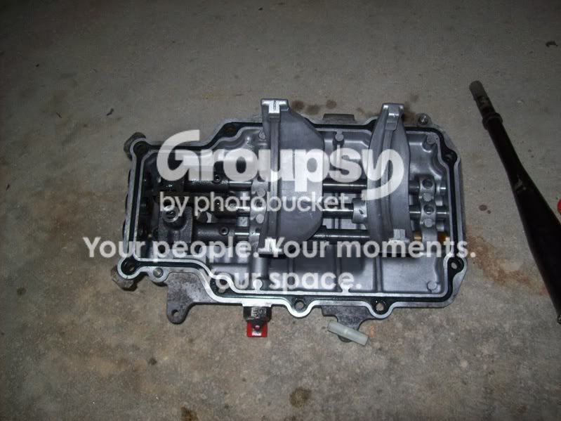

Well, i've been slacking on my rig. 1st gear is totally out in the FM145, so got an M5OD shipped to my door for just a little under $500 that did not shift properly. Due to a bad shift fork on the top cover i replaced it and am getting ready to do the swap. Also bought a set of 33x12.50 swampers, soon i will get a few more wagon wheels to have a complete set. As for a lift 3" xj coils will be on order along with 2.5" lift brackets. I'm not sure if ill buy the brackets or just fab some up. I will be fabbing extended radius arms and a new x-member for the trans. This week i'm going to focus on getting materials for tube bumpers. I'm going to build both front and rear out of 1 3/4" .250 wall DOM. I know its to be overbuilt but i'd rather have it that way. The extra 7.5 i have i'm going to lincoln lock it and ride it out, if it blows ill just swap it.
Heres some pics of my trans adventure
The ugly looking slave, have a new slave ready to go on
You can see in the pic on the bottom right of the plate on the fork that is brownish due to excessive heat
