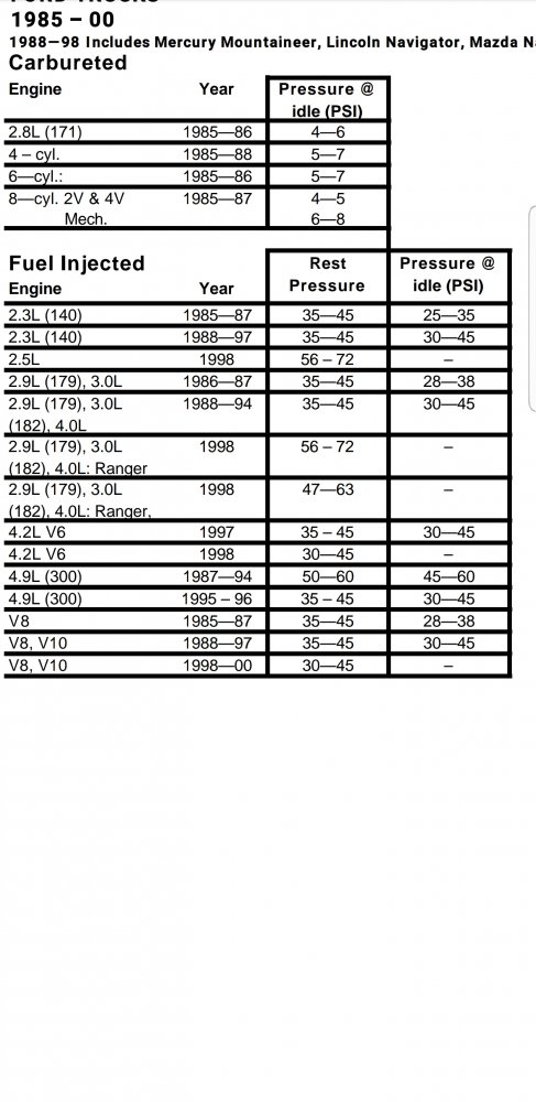

How high is the pressure? IIRC the 300 calls for like 65lbs

BTW...i found this PDF that lists fuel pressures from some tech colleges book. I couldnt link but heres a screenshot...
I was close lol.
Um id get a new gauge. At those pressures you would be exploding lines. I dont even think the pump is capable of that.
I was close lol.
I like your “close enough” better than my 100psi, haha. I’ve tried a couple different gauges.. maybe I need to get a true liquid filled and try that.
