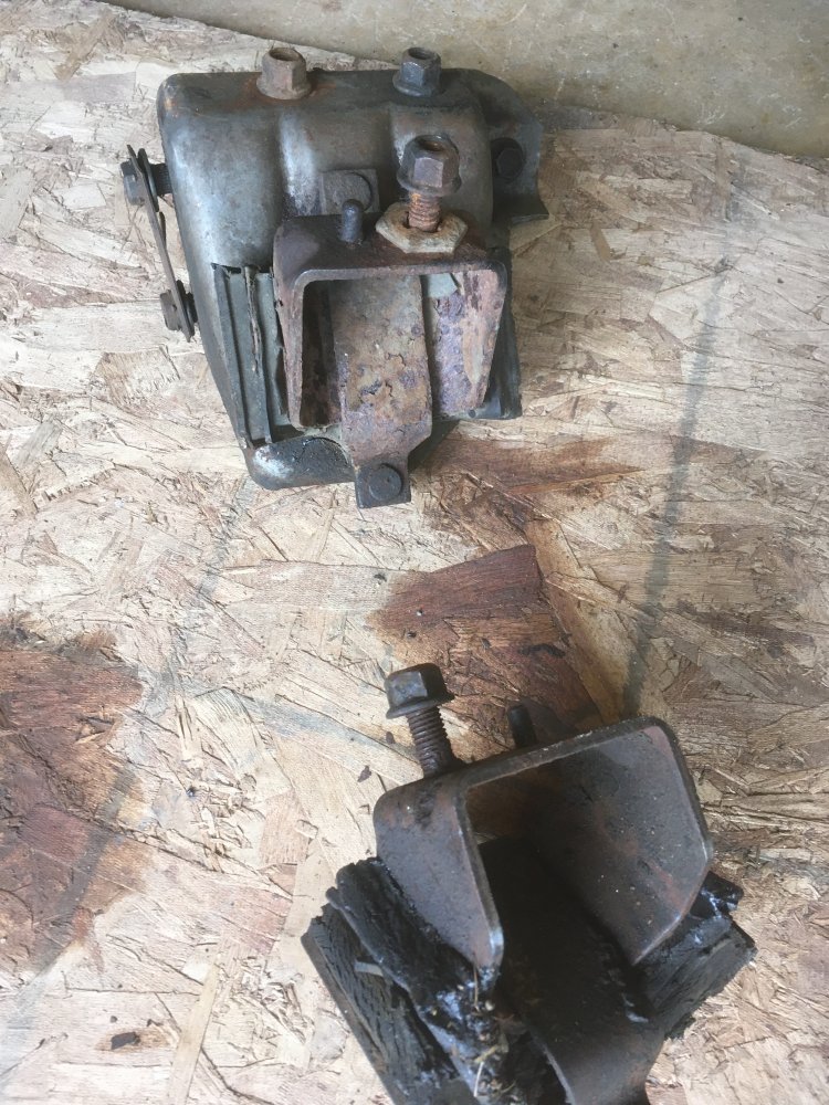

Motor Mounts for DIESEL, Mistsubishi, WANTED!
:icon_welder:I need a NEW motor mount for my 87 Ranger Mitsubishi DIESEL, for the LHS [driverside]! There is only steel remaining on my mount, the rubber is all gone. I do not think Parrotfred is active anymore, though he did provide some good info. There must be some solution to this dilemma. Any sources or do I have to make my own? I may be wrong but I think Mini-Stroke is correct in that the offered mounts do NOT fit. The are all made in India and will not fit the Mitsubishi mount. I bought 2 from Rock Auto and even attempted to modifty them but failed. Any additional attempts will require me to remove the engine and I'd like to avoid that. If I have to I will cast my own. Any suggestions or sources appreciated.
Necro-posting hoping to revive anyone with pictures of 4wd mitsubishi mounts. Have 2wd mounts but need to see what changes with bracket/mounting.
I never did have any luck finding new mounts. And life took over and that rig found a new loving home about 4 years ago. Last I heard it was still going strong tho.
