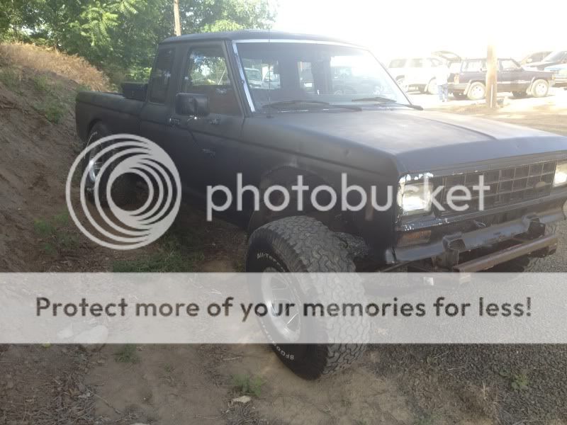

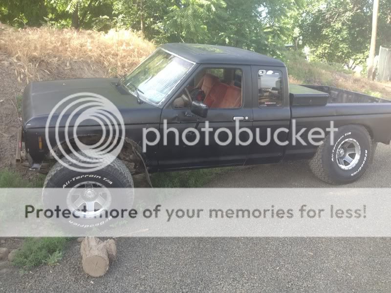

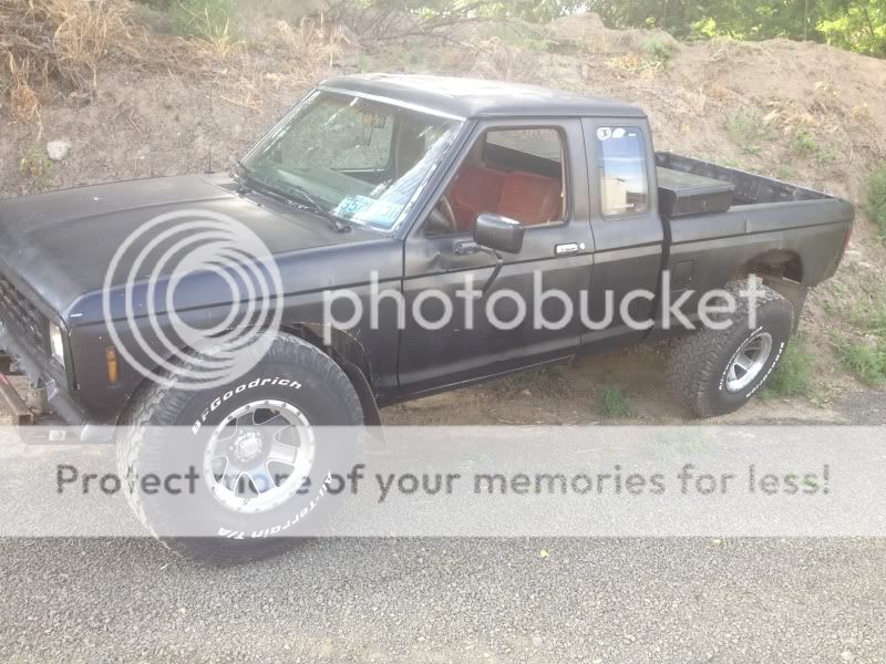

86mudracer, I did lower it back to factory ride height. Was going to run it spring over axle giving about 5" lift but had issues with my steering and leafsprings not working together so spring under it went and it ended up sitting right at the height I was wanting. I can't stand lift, I would rather take time to keep it low.

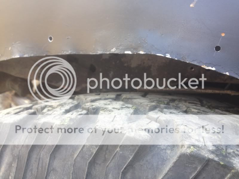

90jurassic2, not sure on up travel yet, have a little more trimming to do and need to mount shocks but probably 2-3 in up travel and how ever much my leafs will let it droop for down travel.
