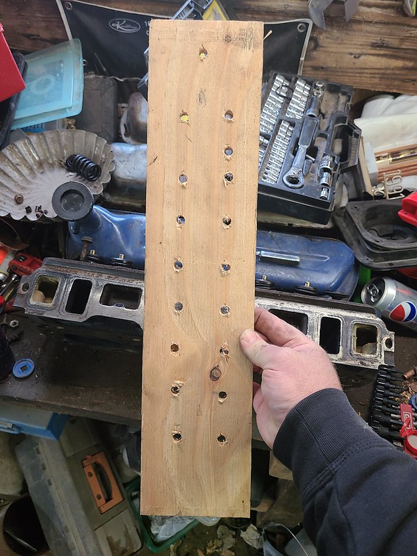

On today's episode of "This old truck" we drill a bunch of holes in a board!

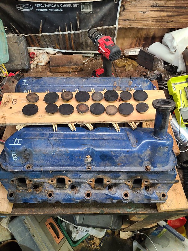

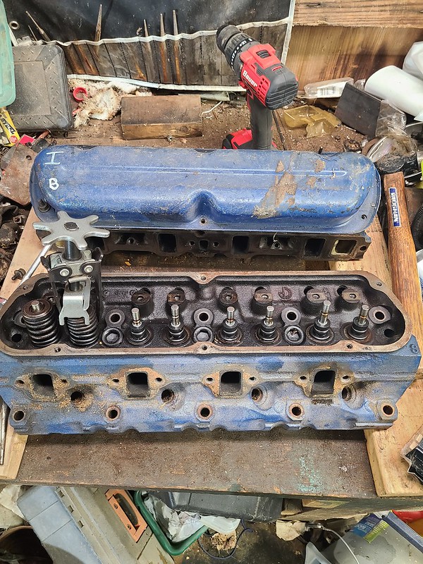

Just keep plugging away pulling valves...
'85 Ranger Restomod

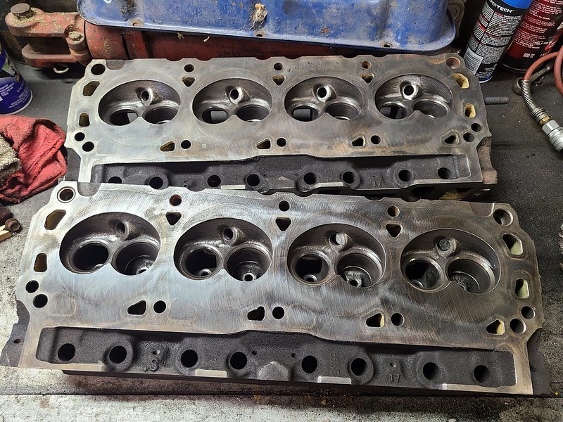

All done, I have two good heads (what original came with my engine of course)
'85 Ranger Restomod
The heads off the "reman" engine, I just don't know. I checked the valves with a deadblow and they are all lose... but this was on the bench when I moved them.
'85 Ranger Restomod
So they will probably go back in the barn and filed under "probably good spares that will need a tour thru a shop"

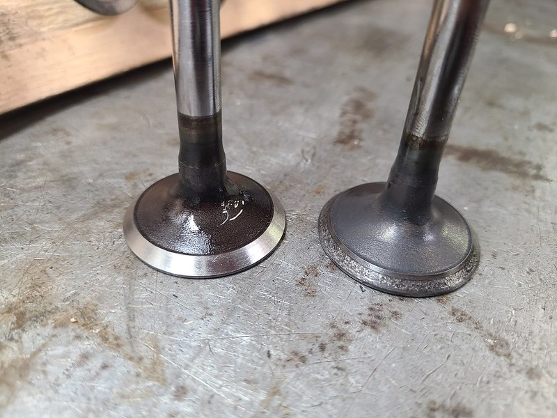

Cleaned up the exhaust valves, they all look kinda tough.
'85 Ranger Restomod

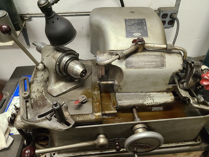

Say hello to my little friend...
'85 Ranger Restomod
Took just a tickle and they are coming out great.
'85 Ranger Restomod

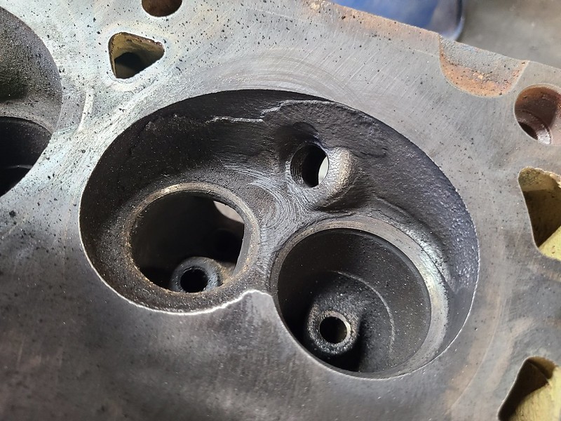

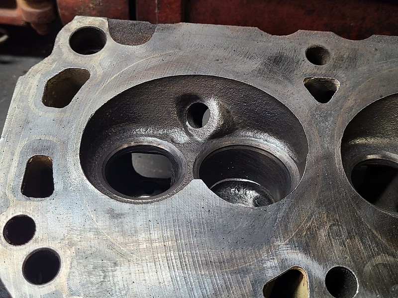

So onto the the heads.
#5 did have a fair bit of carbon buildup.
'85 Ranger Restomod
But they call came around.
'85 Ranger Restomod

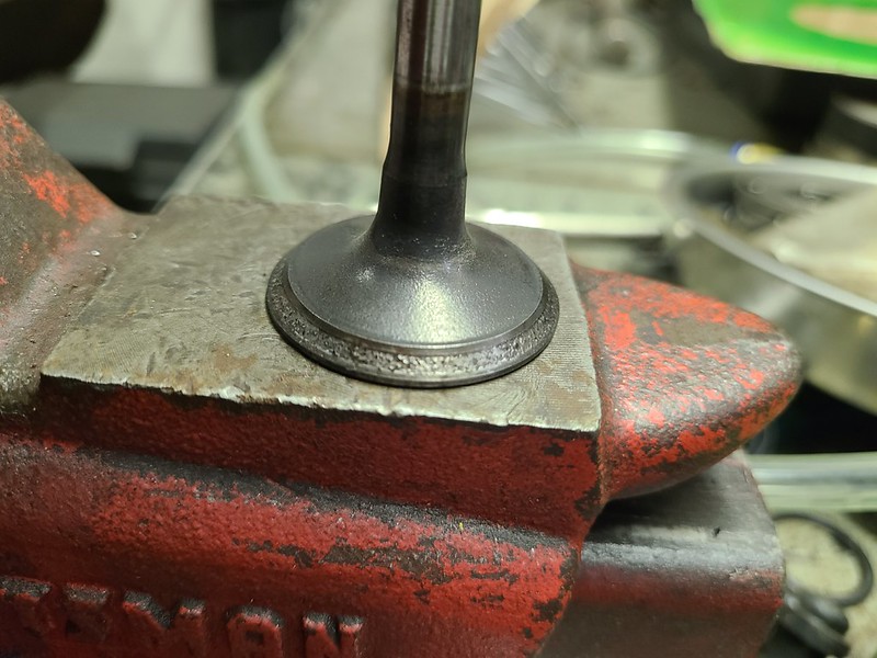

The seats got kind of gunky as i was cleaning out the bowls but they looked good before I started. Dad is going to finish the valves this week and then I can wash the heads and check out the seats for good next weekend before we lap the valves in. If nothing else I did find the stones to touch up the seats if need be,
'85 Ranger Restomod
Been awhile since I've ground valves and it's hard to tell from the pictures... But it doesn't look like there is any margin left on those valves.
1/32" is minimum.
I have close to 1/16", camera angle was intended to show off the surfacing change, not so much the margin.
All good... the picture is deceiving.

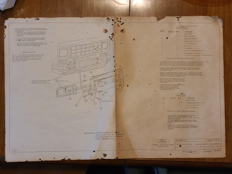

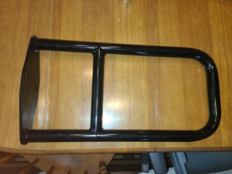

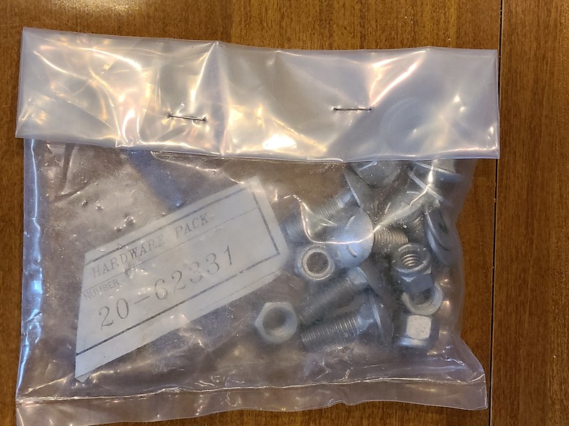

It is the headlight "brush guards" for the factory grille guard, curious the one in the picture has two bolts spaced farther apart and these have three.

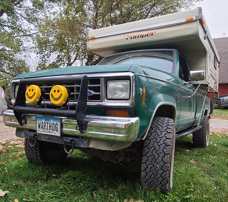

I knew this going in but when I made my current grille guard 20+ years ago I made it wide enough for the mounting brackets to be to the inside, I did (and still do) think it looks cleaner than having the brackets to the outside.
'85 Ranger Restomod
So as far as just sticking these on my current grille guard... they stick out a little too far. With the modern trend of massive grille guards it would probably be ok but it would bug me.
So they are waiting in the box until I get mine done.
And I notice they will cover the top mounting bolt for the cross tube. I was thinking about making it bolt together like the factory one upon closer examination the side plates of the OEM one I found on ebay a couple months ago the cross tube mounting holes are countersunk... which is kinda hard to DIY.

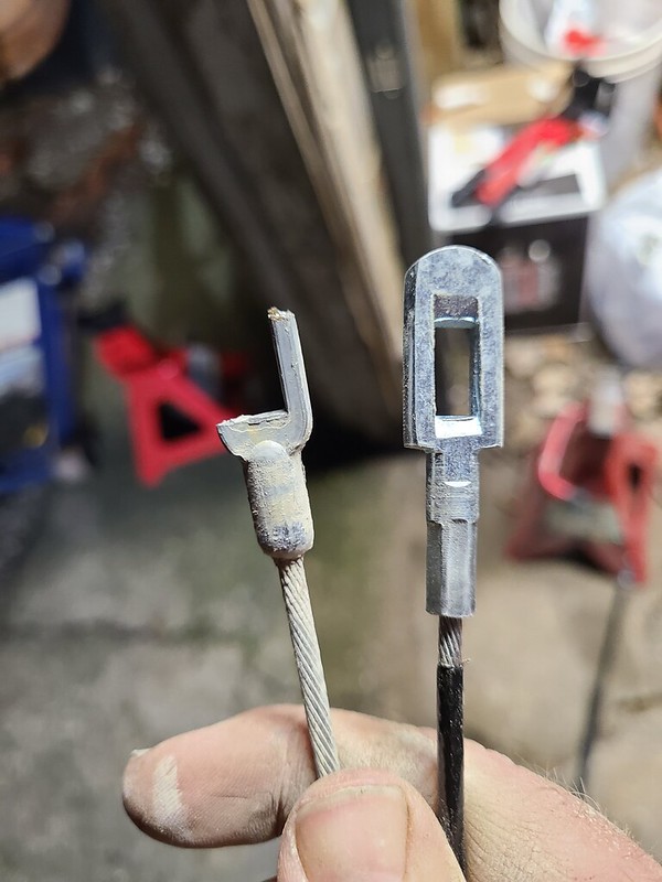

Fixed the parking brake. Bendix cable has a slightly heavier made end than whatever cable I had before and the cable is plastic coated.

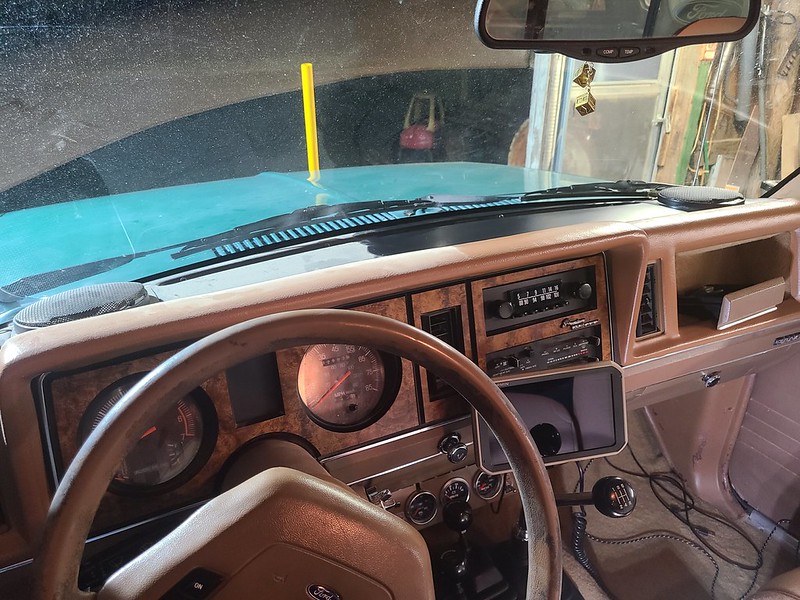

Started cleaning up the truck for a car show this weekend while the shop lions lurked around.
'85 Ranger Restomod
Started dusting the interior which it desperately needed.
'85 Ranger Restomod

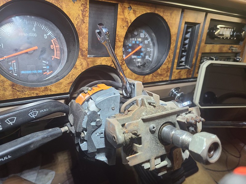

Which escalated into the ol' "first gen steering column snug"
'85 Ranger Restomod
I need to wash the floor mats and the interior is done. Need to do the engine tomorrow night, it is just a show and shine so I doubt I will wax it.
