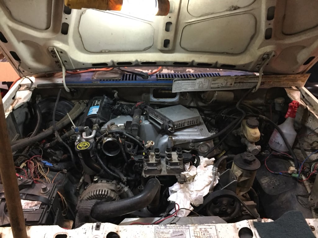

Quick update:
Only get to work on it a few hours once in a while but I’ve got the upper intake manifold on, except for back bolt, clearance issues with firewall/cowl cleanout cover, going to massage it a bit for clearance and use a stud instead. Also starting to do some wiring and auxiliary engine type stuff.
Not everything is in place yet, a few parts are just laying on top:
Hope to get some more done soon.
