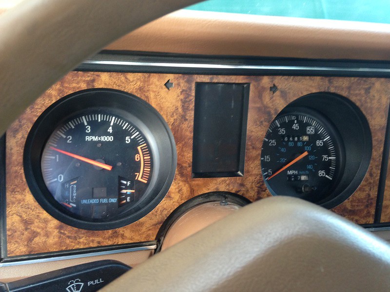

83-86 gauge cluster w/ tach swap
Brief Explanation:
I have not seen this topic covered before, so here goes. If you have an 83-86 truck, chances are, you have the gauge cluster that has either dummy lights or engine gauges on the left side but no tach.
I wanted a tach and did not want an aftermarket one since it's just one more thing to mount somewhere, so I snagged a gauge cluster from an '88 Ranger at the junkyard. I soon discovered that it is not a plug-and-play affair, as you may know if you've tried this.
The problem lies in the fact that 83-86 trucks are missing some wiring required to run the tach, specifically the tach signal wire itself. Everything else is there, you just need to repin the green cluster plug and add ONE wire!
I know for sure this works on an '86 with '88 gauges. YMMV. I will not attempt to tell you what color wires you need to move, only what wires go where, as your wiring harness may have different colors than mine (and likely does.)

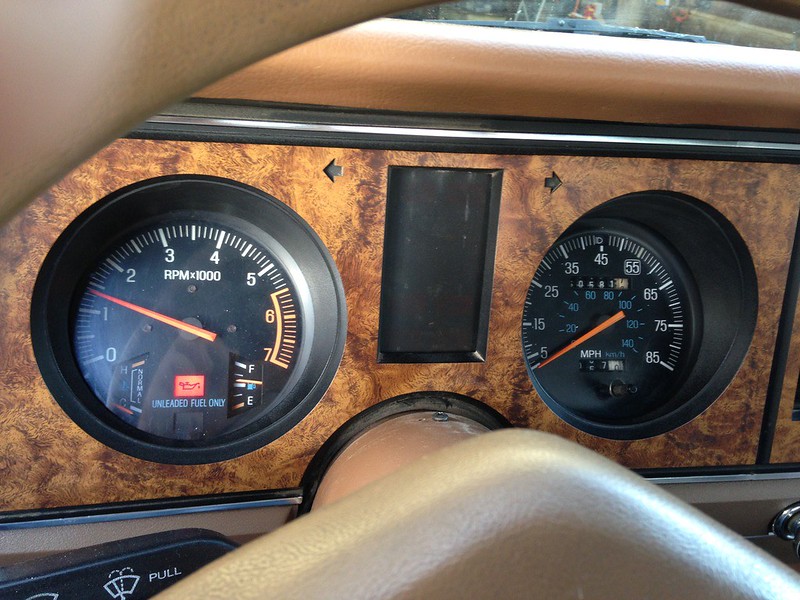

Attach both harness plugs to your new gauge cluster. Start the vehicle, verify that tach is now working. If so, verify that your other gauges are working, reattach speedometer cable, put the dash back together, and you are done.

Thank you for taking the time to figure this out! Should make it easier to add a tach to my future projects, and to my 84 BII with the 4.0 swap, including the harness that I thinned down for the engine/ECU to run. I had thought about it, but, never got around to doing it.
Just what i need...
Oh dude, this is just what i was looking for, thanks.
No prob, I should mention though, that your tach may not read correctly depending on what engine you have...and what engine the donor vehicle had...etc. I have a 302 in this particular truck. The tach reads correctly at idle but progressively reads higher than it should as RPM increases. There is a fix for this but it involves modifying a resistor or something within the gauge cluster and I have not had time to figure it out yet.

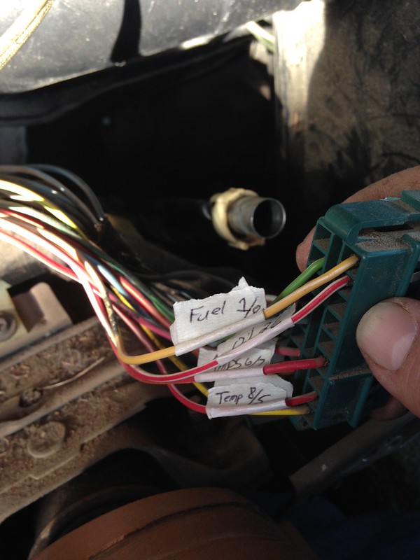

I have a couple additions/options.
First off, before I changed anything I used Shran's writeup and tagged everything with function and both what slot is in now and what slot it needs to be in. It worked great, stupid easy.

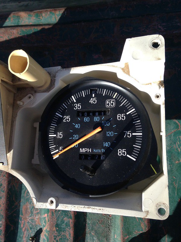

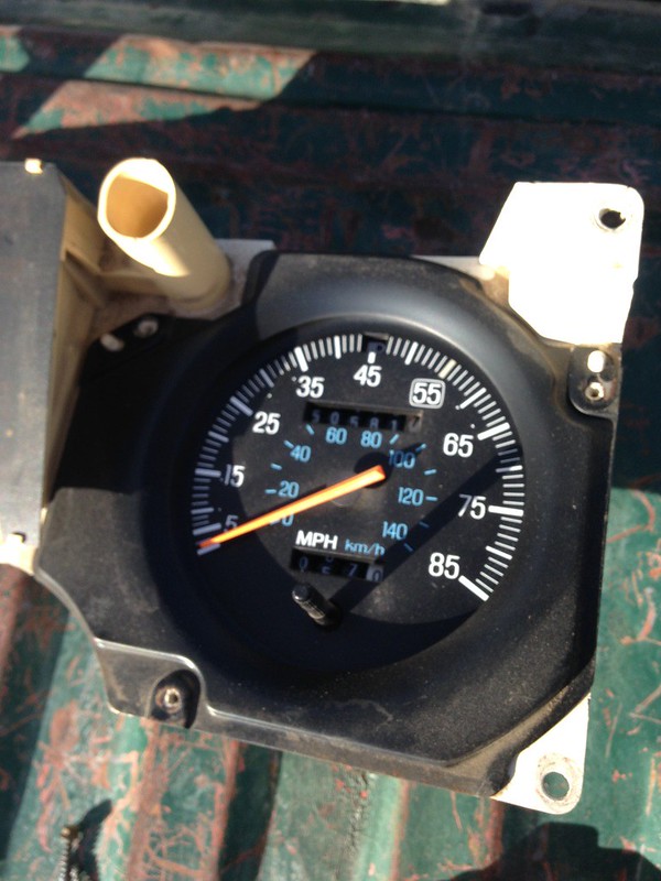

If you want to keep your original speedometer/odometer it is simple to swap them.
Tools needed:
7/32" nutdriver
1/4" nutdriver
Time: 15 minutes if you dawdle.

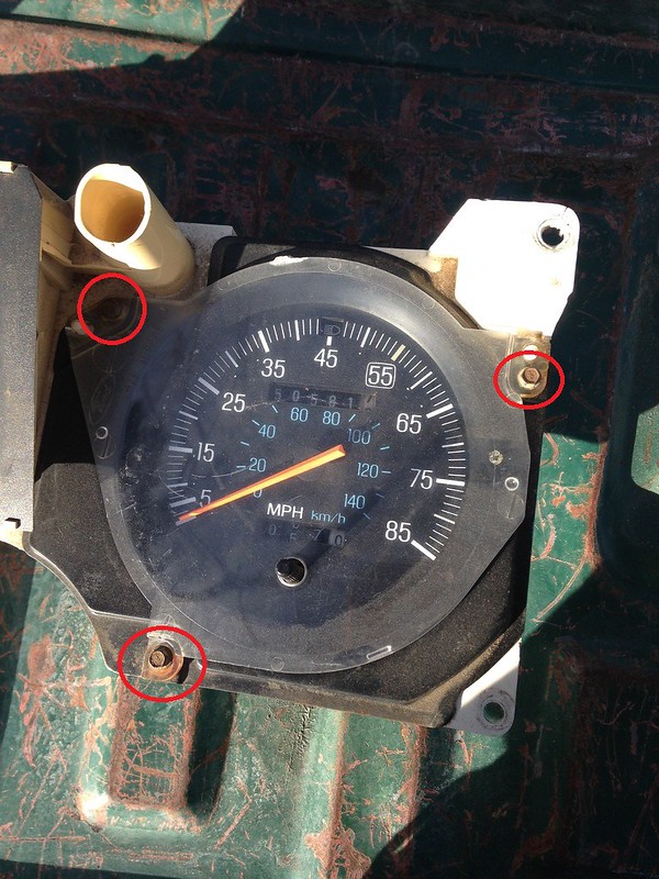

With the cluster removed from the vehicle, first remove the lens and trim from the speedometer pod by removing the three 7/32 head screws.
[url=https://flic.kr/p/YHJRmo]83-86 gauge cluster w/ tach swap
Then lift off the black surround trim.
That just leaves the gauge itself.
[url=https://flic.kr/p/YHJRih]83-86 gauge cluster w/ tach swap

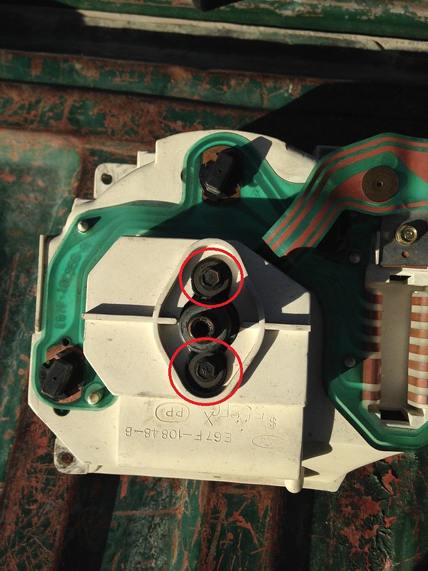

Flip the cluster over and remove the two 1/4" head screws, be ready for it to maybe fall out as you remove the last one.

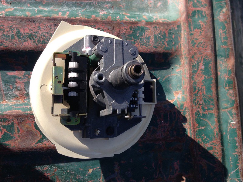

Then carefully push the gauge pod out of the cluster.
Repeat for other cluster, installation is reverse of disassembly. Both lenses will interchange between the tach and non tach cluster but only the speedometer side trim will (obviously)
