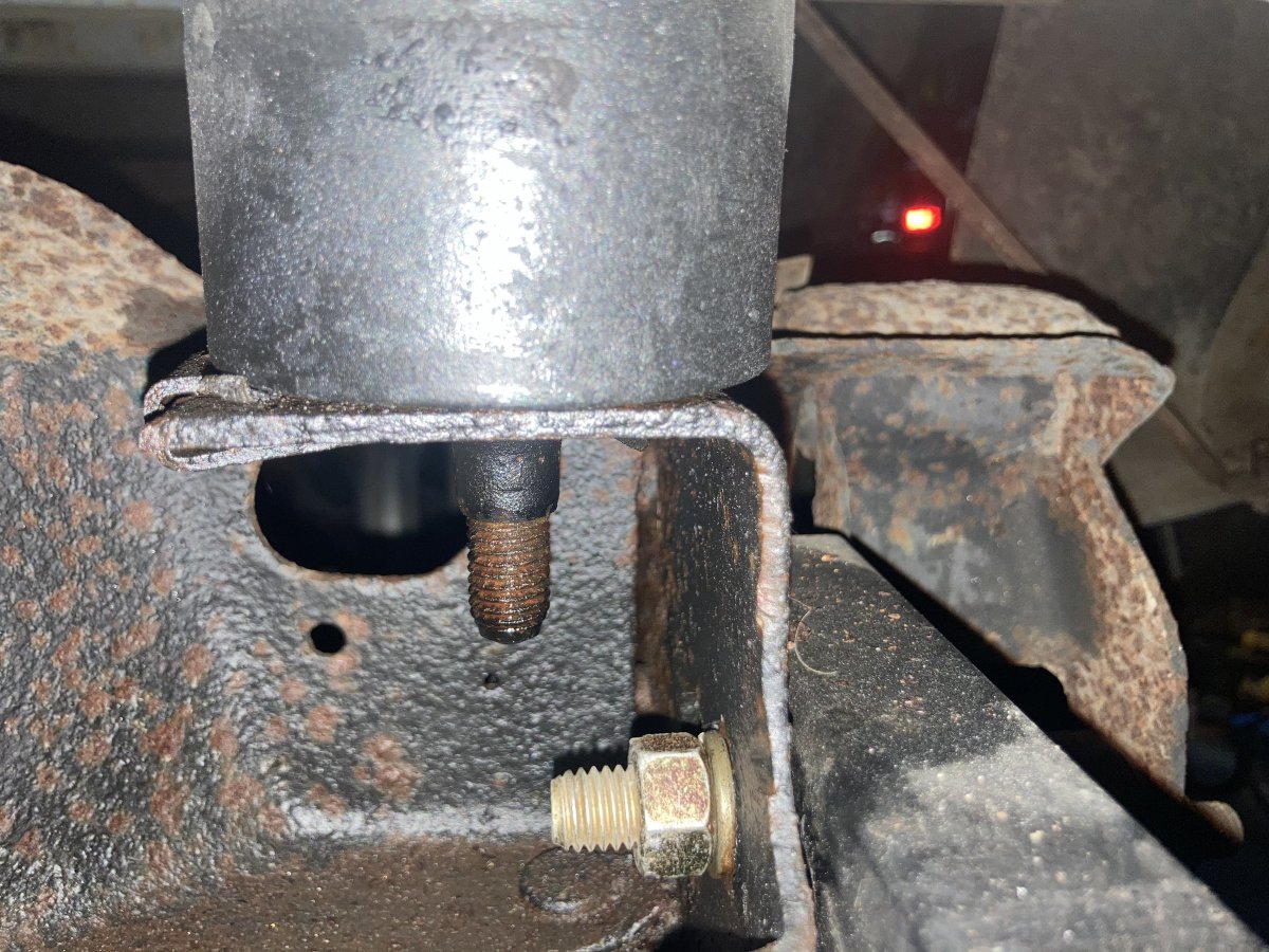

Here’s my question about heating the bolts and/or clip nuts of bed...
Is that small black neck segment surrounding the upper threads actually part of the clip nut? Is it where the stubborn threads are that’s holding me back? Should I torch it as I torch the bolt head? And is this thread neck made of metal or is it some hard plastic material that will simply melt if I torch it and thus would only make things worse?
52178
Yup, that is the threaded part of it. It is steel.

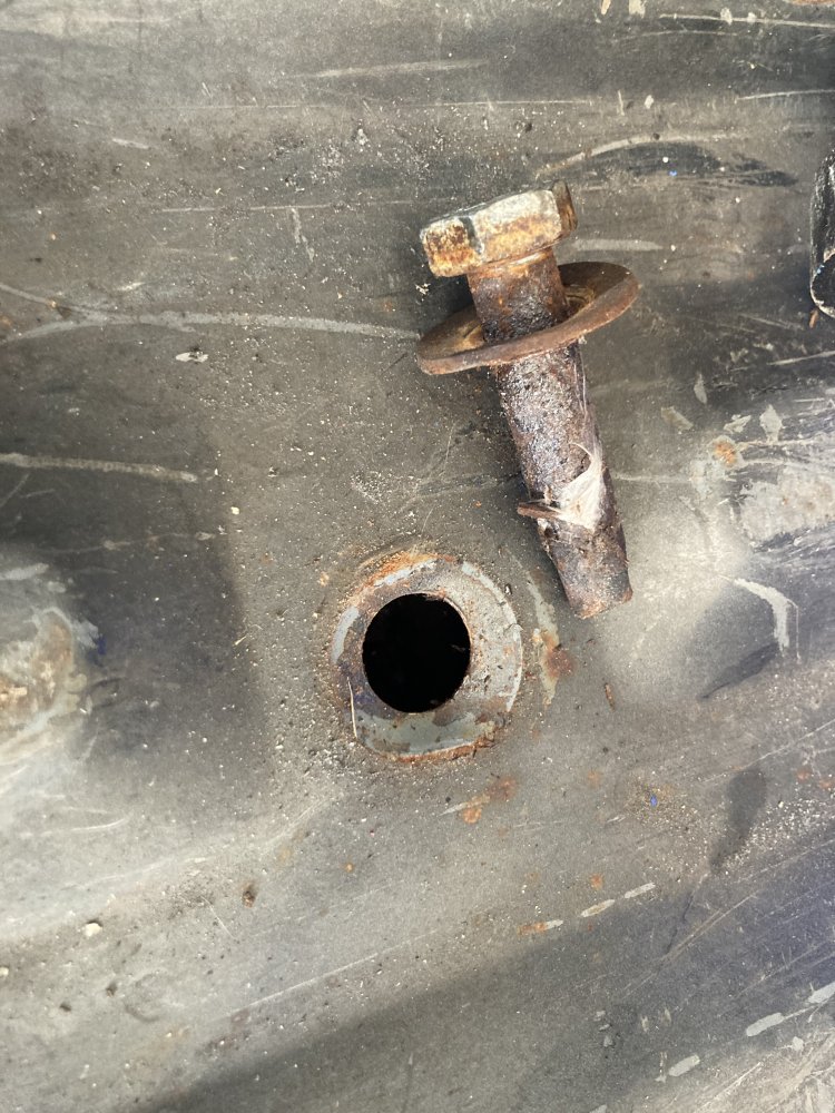

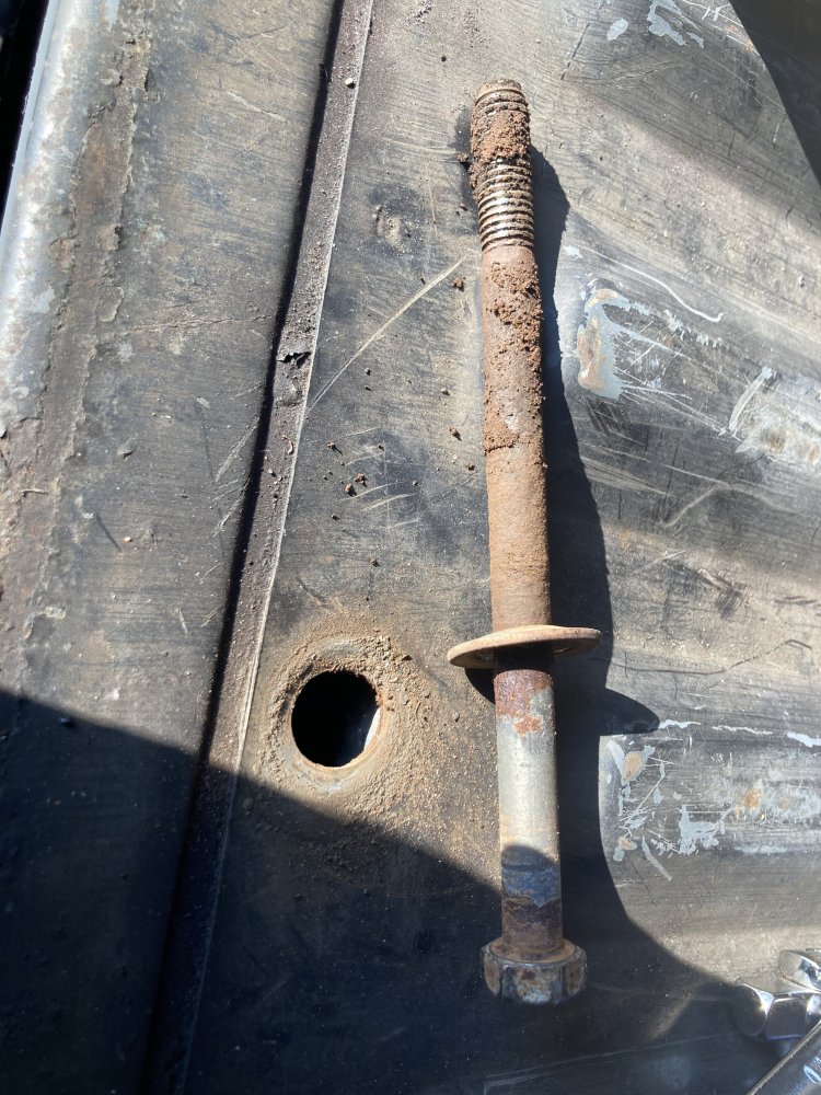

One bed bolt done. Torch and breaker bar slowly.
Anyone know of how to find new replacements of bolts and clip nuts? I could maybe clean these up but working fresh would be nice.
Hasn’t been easy to find body mount hardware either.
52192
Somebody did not sacrifice a chicken correctly...
James Duff has hardware kits with new poly bushings. Factory cab hardware will be a PITA to deal with too.
