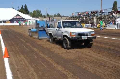

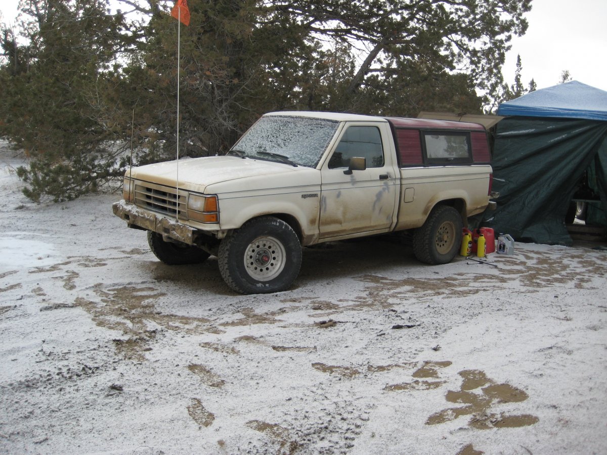

Here's a couple pictures of mine on 31's back in the day... I had Explorer rear springs in so it sat high in the back, as you can see they're tight up front but they did fit. I'm sure the home made front bumper helped clearance... a little bit of leveling lift wouldn't hurt...
The first pic is just for fun, I forgot I had that :), the front suspension is unloaded at that point so that makes it a bit taller... that sled is heavy, I think that run was before the turbo...
