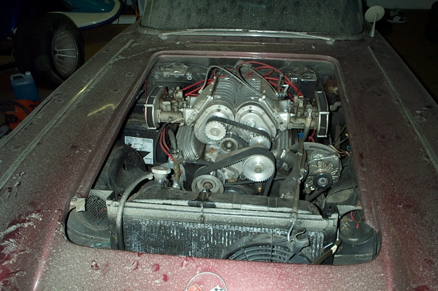

here is a test for you. here is a 62 vette with a 350 twin blown engine. see if you can guess the net hp after dyno. here is a hint.... to turn the blowers took 100HP. this is a car my uncle had built in the late 80's. he can't get the teflon to stick on the blades anymore so its been parked for years as it sits like this (dirt and all)

  • '78 Cobra 302 into 87 Ranger?
here are 2 very interesting articles that will show what it takes from a factory that has the dollars behind it to engineer streetable cars/engines
thats bullshit of the highest order. that was results from guys with a gun to their heads and hands tied behind their backs with a boot pushing em under water.
if you told them their only requirement was to make 350 wheel horse power they would have got ya 500hp on pump gas.
