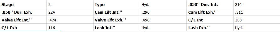

77 302's had flat top pistons. The low comp ratio came from the 70 cc combustion chambers. The deep dish pistons were used from 72 to 76. And then there's the cam specs. Lift was not much. Duration was not long.
In the 70's they didn't use roller chains, they had "silent" chains with nylon teeth on aluminum cam sprockets. They were especially silent after 40-50k when the teeth wore down and the chain jumped. From 73-76 Ford increased the deck height on 302's by .023" to lower compression, I think because they had a bunch of pistons they wanted to use up. They just didn't know how to meet the ever changing emissions rules of the day; they dropped compression, retarded timing and limited advance curves, leaned out fuel mixture, added convertors to exhaust that was already too small, then added EGR valves to get rid of any residual smooth running or power. My 77 Mustang distributor centrifugal advance wasn't fully in until over 4500 rpm, in stock condition it would get 12 mpg and run a 17.7 quarter mile at 78 mph-according to magazine articles from the time. I like the 13.8@102 and 20 mpg it now does much better.
