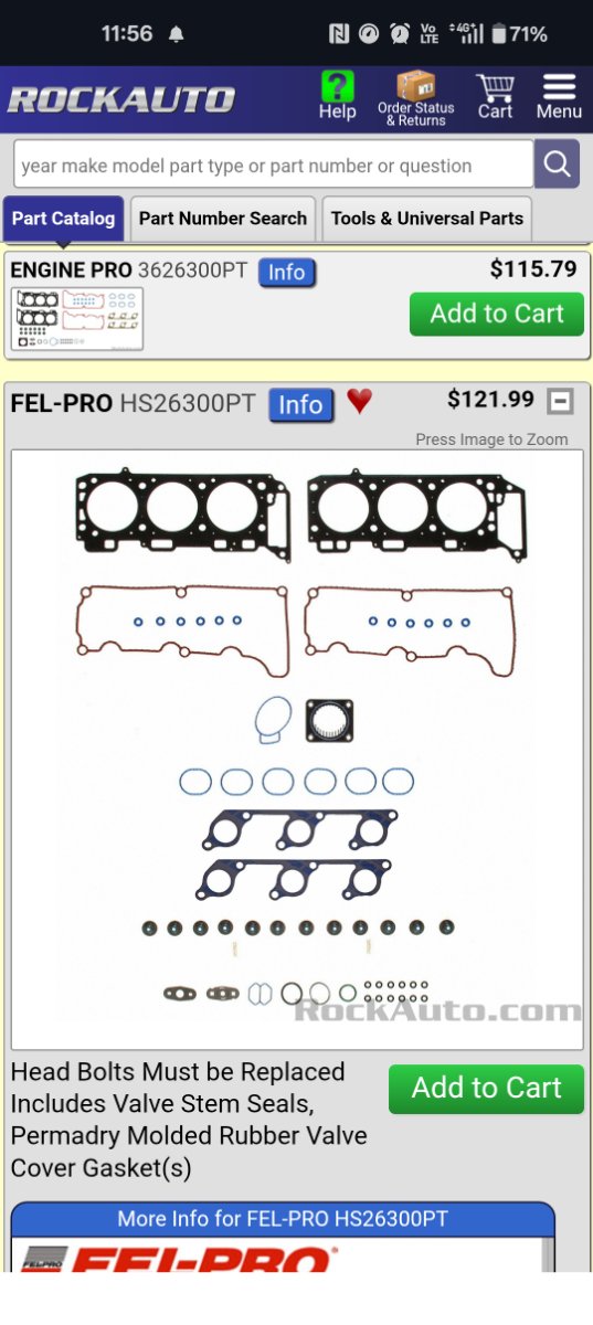

Is this every gasket I'd need to do head gaskets? It doesn't say it is I'm just wondering if that's what this kit is for. So this kit plus head bolts, water pump, radiator and $1200 labor and I'll have it whipped? I already have new upper and lower radiator hoses and new thermostat housing at my house that I hadnt put on yet. If that's the case I don't see what I've got to lose (except $2000😂). They swear he does good engine work.... I'll even loan him my Ford factory service manual.

Then as @85_Ranger4x4 says you aren't just replacing the head gaskets, you are replacing the timing set* which is $400 plus the $500+ for the quality timing set tool**. And the head bolts are throw away single use items. You need the timing cover gaskets in addition to the head one.
Then you have the 12-15 hours to reinstall the engine back into the truck (as @19Walt93 says replace torque converter seal and may be engine rear seal while they are accessable), button it up and add fluids.
You'll find the $6k price isn't that outrageous (given current shop rates).
*SoHC engines are notorious for timing chain issues, for which the engine must come out to fix - an ounce of prevention is worth a pound of cure
**A shop should have the tool, but you buddy might not. Yes, there are lots of cheap ones out there, but is it worth a ruined engine to cheap out on the timing tool?
