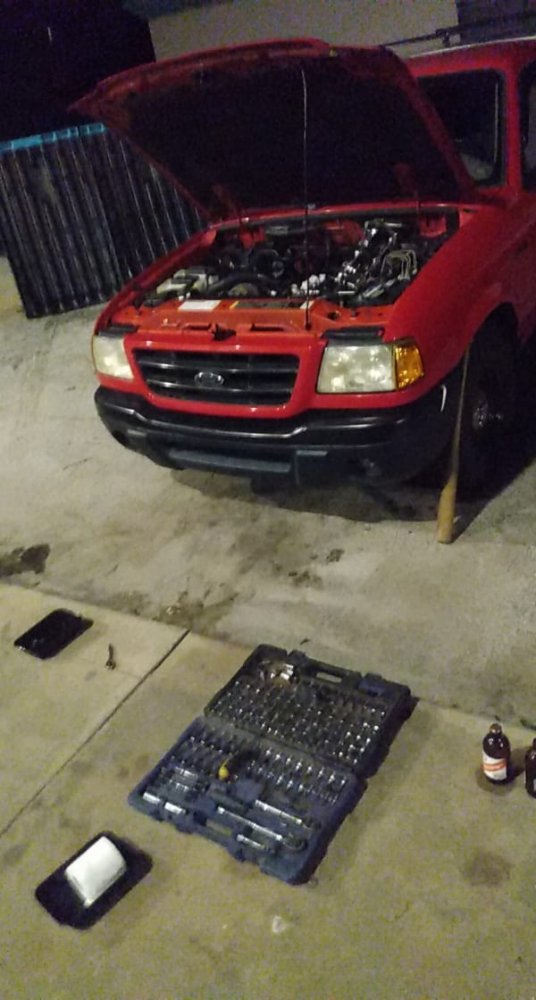

Im going to try and reproduce the symptom in park. I'll report back. I can't get it to do that rumble stuff in park but ill keep trying, I was thinking maybe torque converter? The 3.0 uses a harmonic balancer so it couldn't be that, right?
