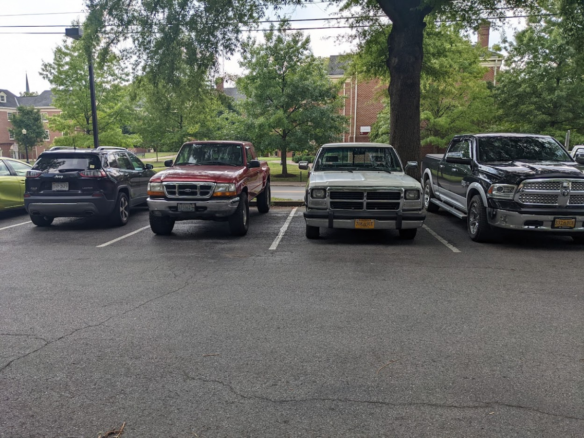

A/C works well now. It was fun driving it back to work after the shop finished with it.
64633
Nice side by side shot of the older vs newer Dodge Trucks there, too.
If I'd panned over to the right, you'd get a crew cab Frontier ('02) for comparison too.
