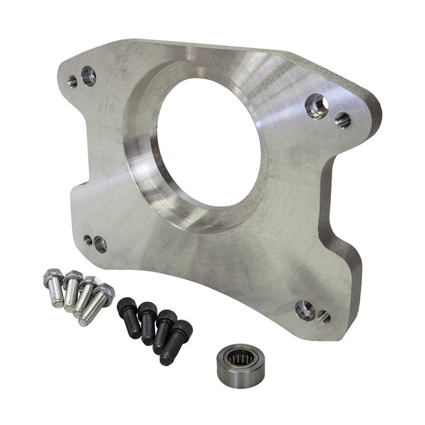

The 4.0 trans will not bolt to the 5.0/302 block. So not only will it not handle a built 5.0, but it won’t bolt up without adapters.

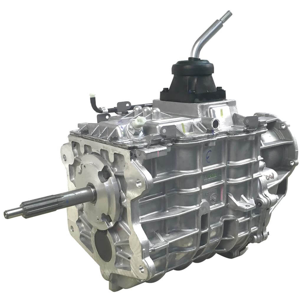

this gets a nv4500 to a sbf...
last i looked 150-200k miles 6.0 was running 1300. so from there if it was usable with just doing cam bearings and typical freshen up...and a gm nv4500 trans in usuable condition...12-1800. i would probably run a 241 case or a 208 ford case with a 32 spline input and a clock ring...both of which i own already....many.
