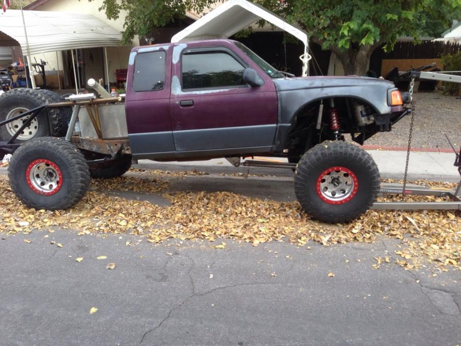

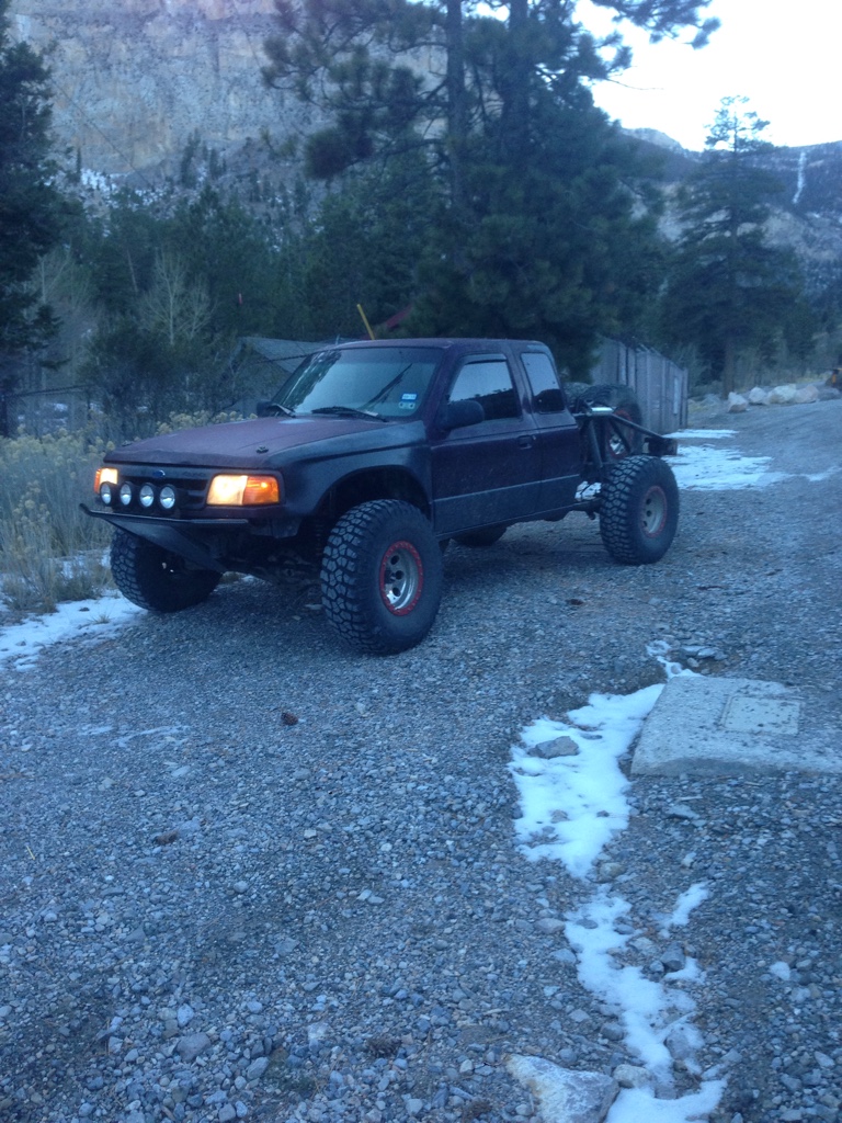

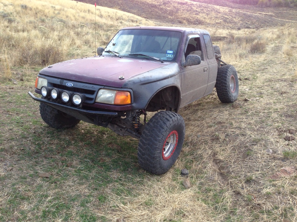

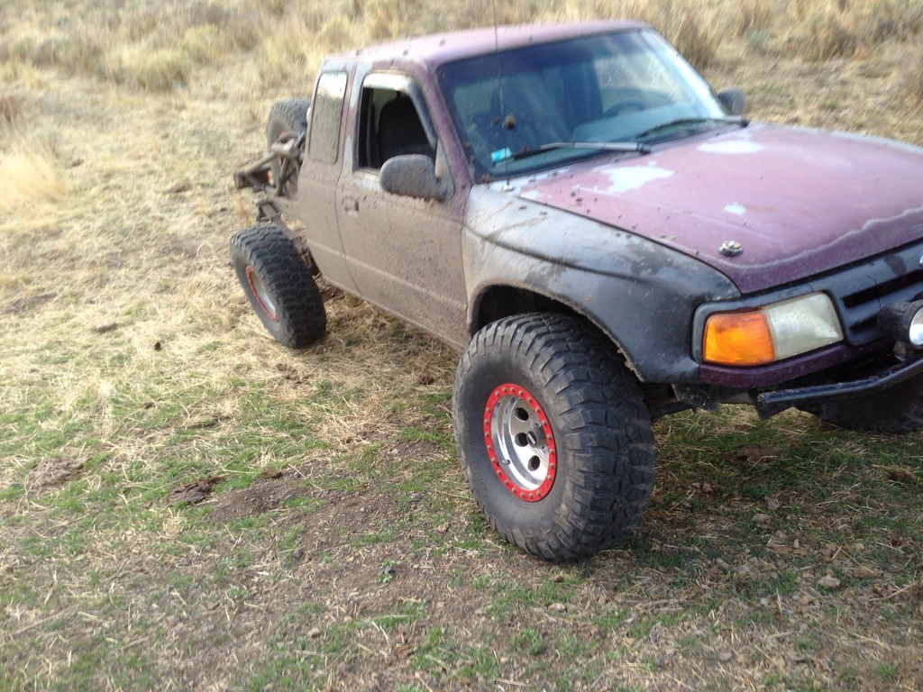

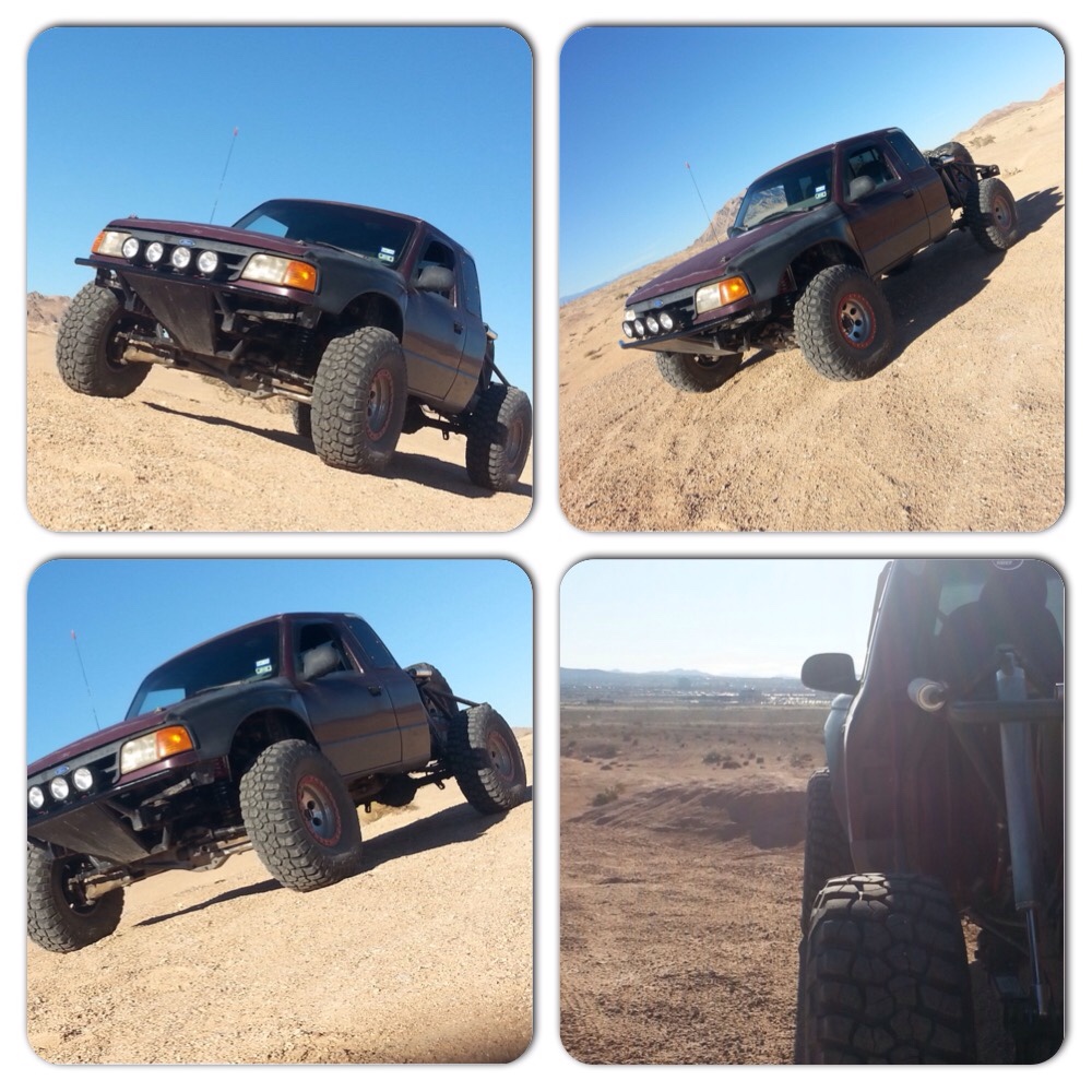

Couple droop pictures for you guys
No real Big updates just fixing small issues. Window regulators, actuators heater core did a good tune up piecing my exhaust parts together just enjoying the truck for a wile since it will be going under the knife in a big way pretty soon.

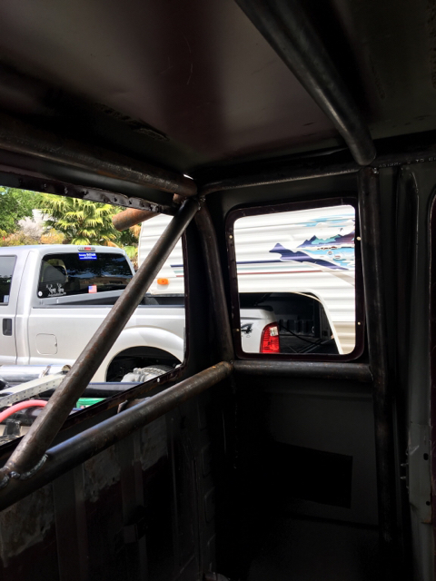

Well big up dates coming soon I have 120 feet of 1.75 .120 Dom tubing for a cab cage and adding onto the engine cage mount bypasses in the front redo mounts to accommodate a 3.5 5 tube bypass out back
Nice build. Give me inspiration on doing something with my 4x4

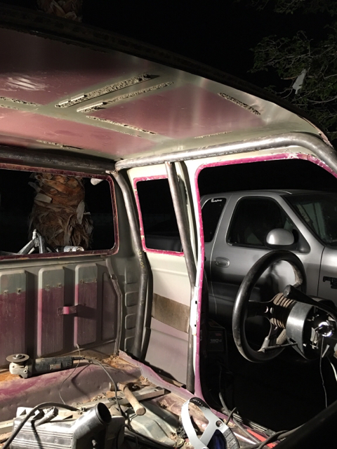

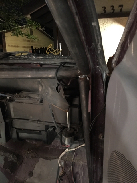

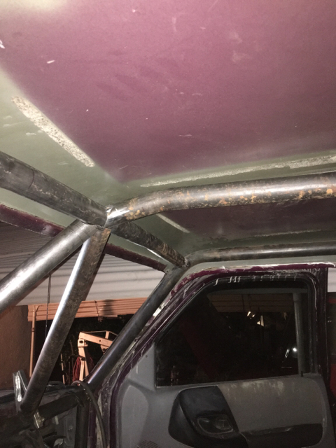

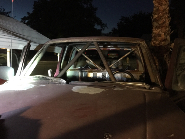

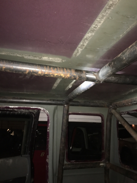

Nowhere close to done but here is the start of the cab cage I got a new job working a ton of hours now so progress has been slow but one day I'll have her done and rolling again.

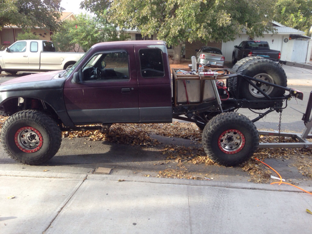

Yea I have both rock sliders done and mounted also that's what the cage is running into then the sliders are tied into the frame with 6 pieces
small update other then the giant pile of parts sitting in the corner. Post some pictures and details of that tomorrow
