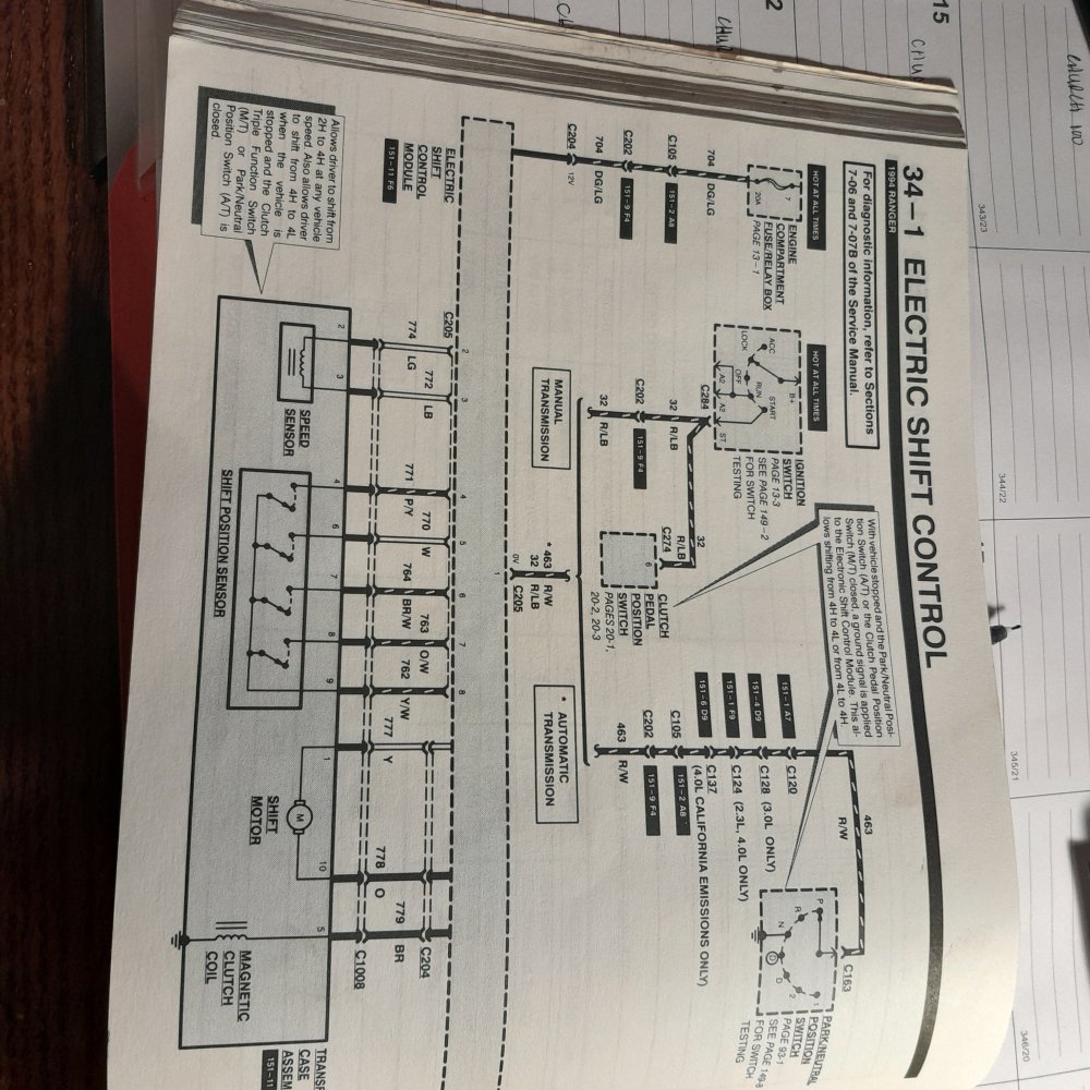

what does the 4x4 switch need to send power to motor i have a auto wiring harness from the explorer and a 5spd from ranger
Ding-ding...
Thinking through this, I would guess it has to do with the signal it gets from the tranny.
Take a look at this diagram (it's from my 94 EVTM) but it may offer some insight.
