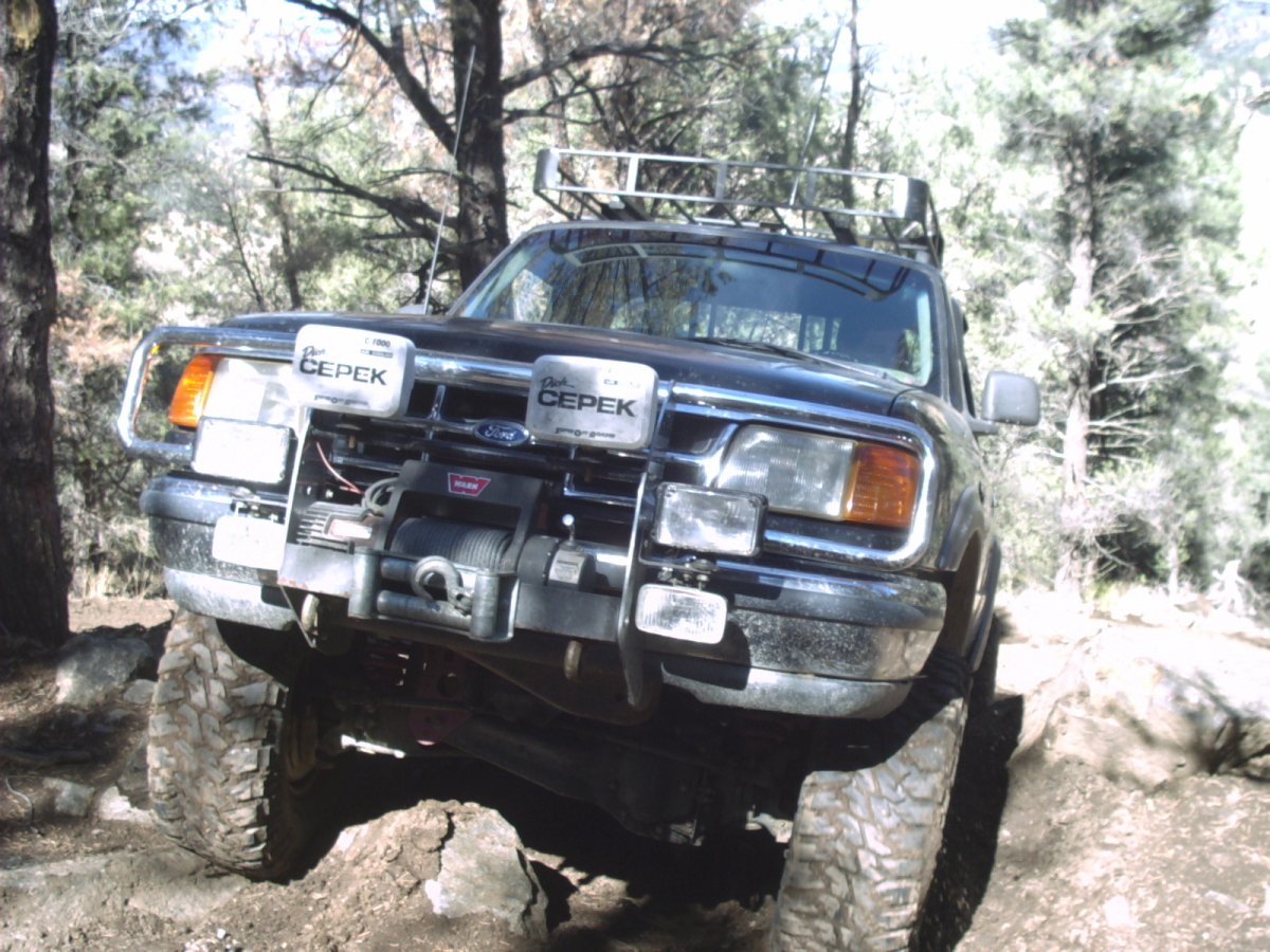

On my '94 I mounted hooks underneath my winch carrier (Warn Trans4mer kit, I'm not sure they're still making these anymore though)
