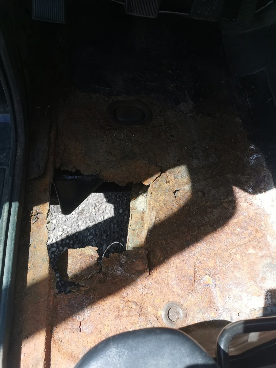

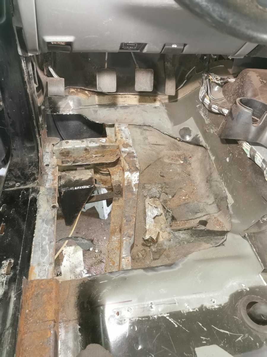

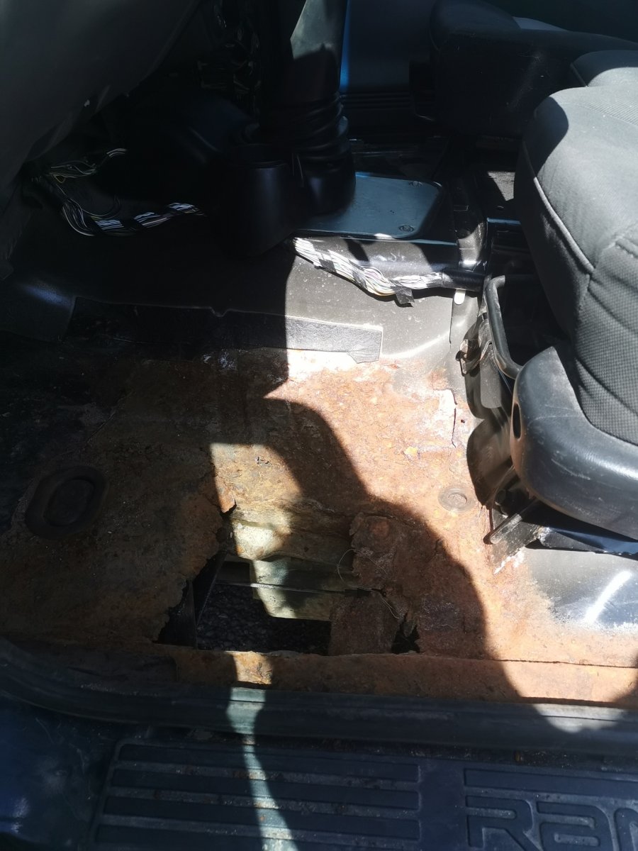

So I have a 2002 ranger that needs a larger floor patch that I want to make. I'm completely shocked to find that nobody sells a floorpan for this year of truck.
There are pans for 1983-1992 but nothing after. Has anybody tried the older pan in the newer truck? Or have a source for a proper year pan?

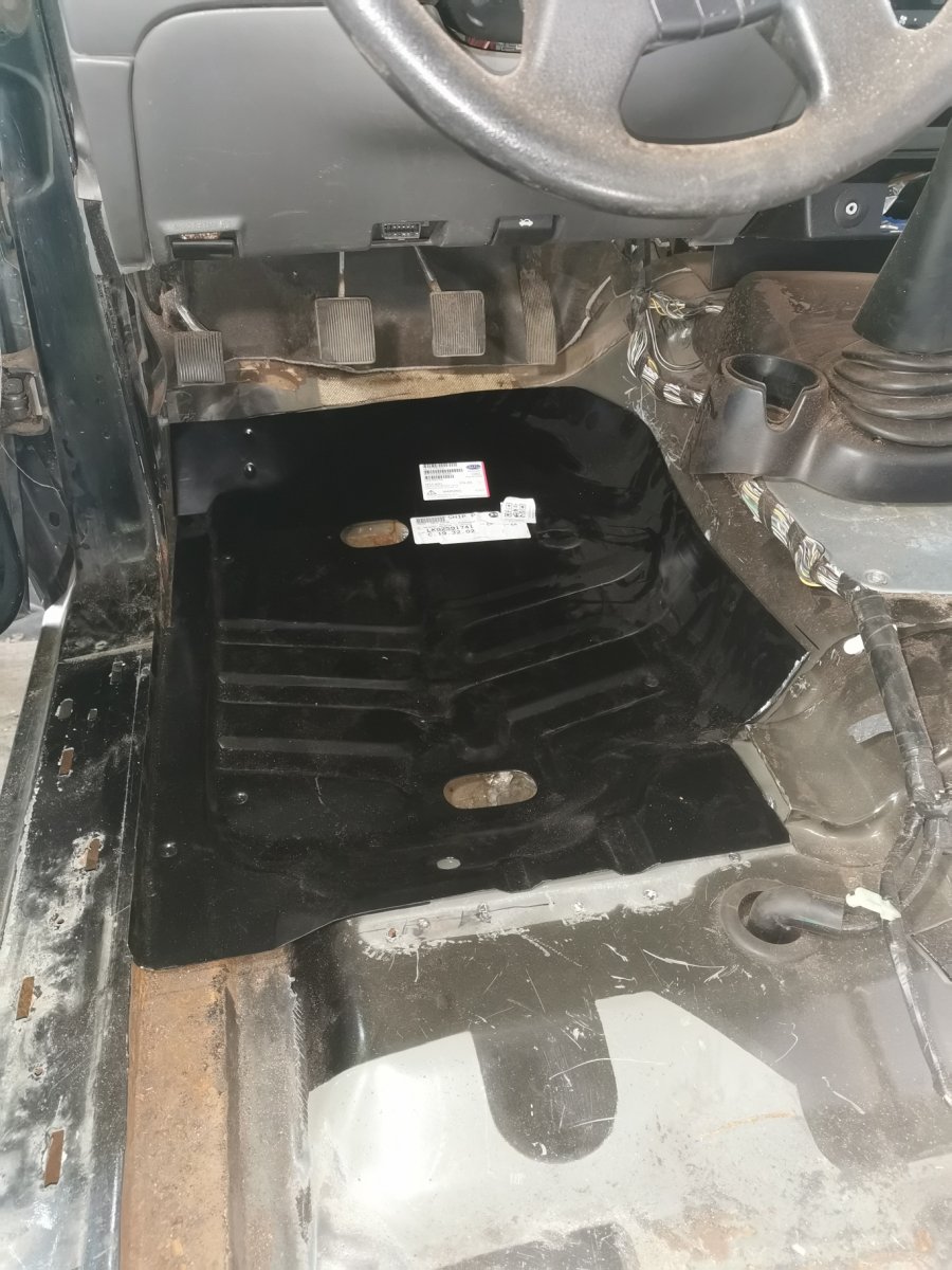

Well I couldn't find the info anywhere. So I'm going to ad it here.
I did buy a first gen pan figuring even if it was different it would be a good start and I could modify it. Well, It was more than just a good start, it's a direct fit. I have to do some other metal work but this gets me most of the way there now. Very happy and wanted to ad this answer for others, since I found many forum posts with this question but nobody decided to try and report back using an older gen pan.
( it's just sitting on top of the old floor in this photo)

Appreciate the offer, but I'm in Canada. and as you can see I actually got a good resolution.

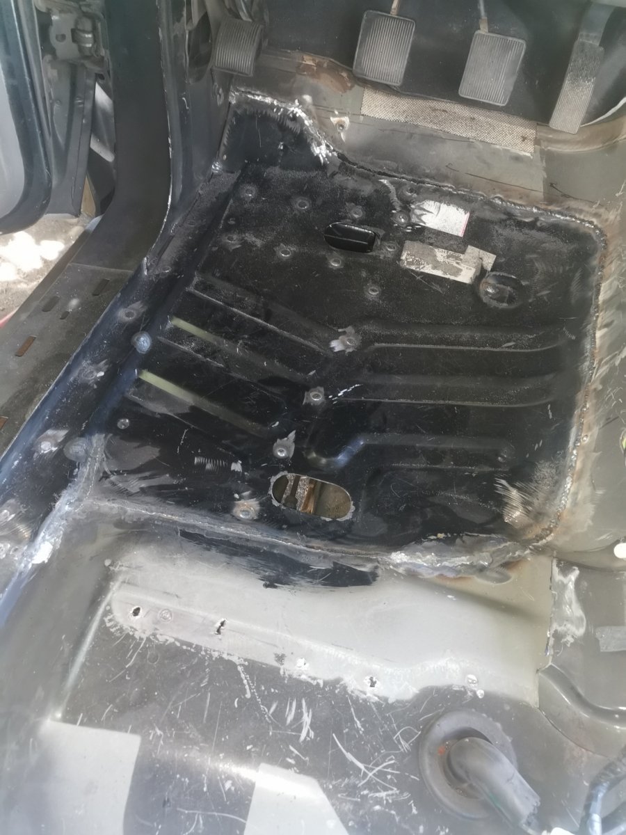

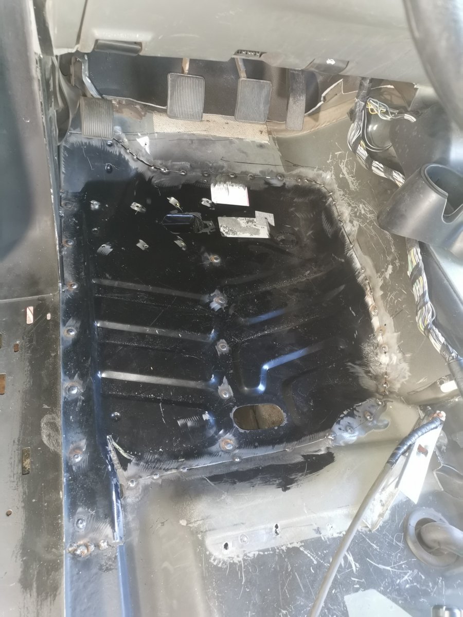

The 1st gen pan has a narrower inner door sill. I just cut a notch and made a smooth transition. I used a little MIG welder and a 3" cut-off disk on a die grinder These panels are about $100 on amazon or eBay.
