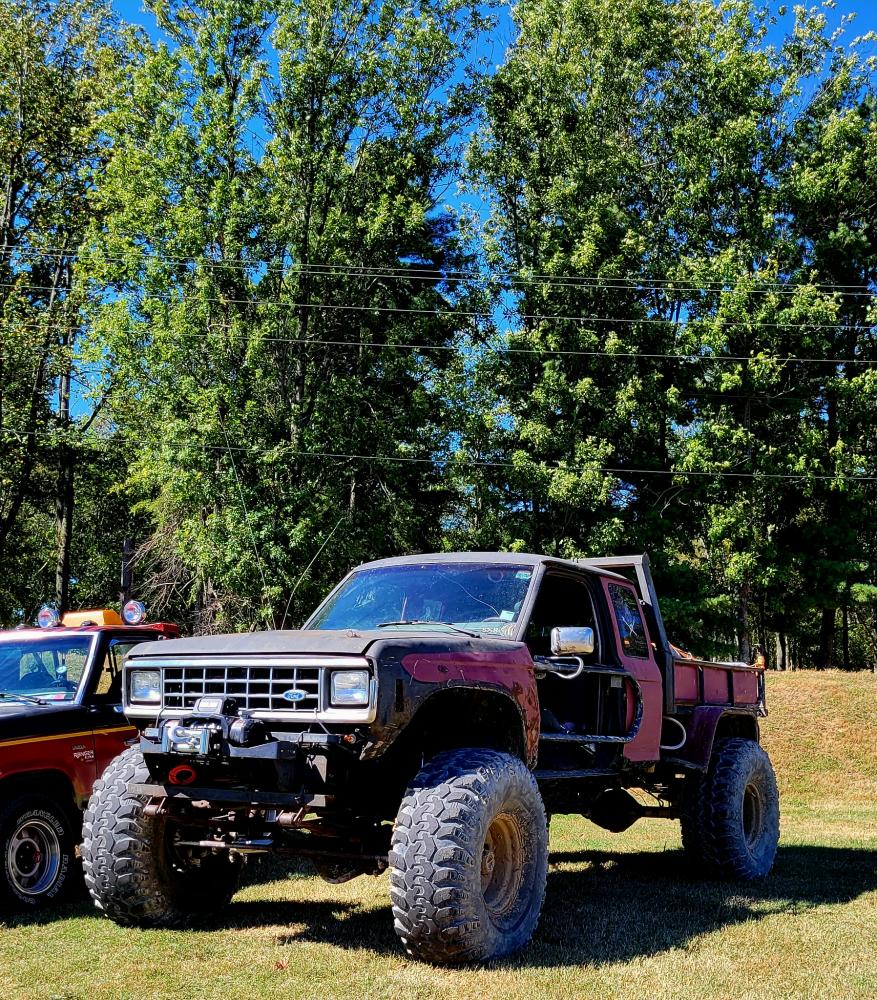

I'm going through a similar process with my 5.0l swap. But I'm using a complete stand-alone digital touchscreen display.
@85_Ranger4x4 may be converting his 85 gauges to digital in his project. He is using an aftermarket ECU. But he may have some useful insight for you.

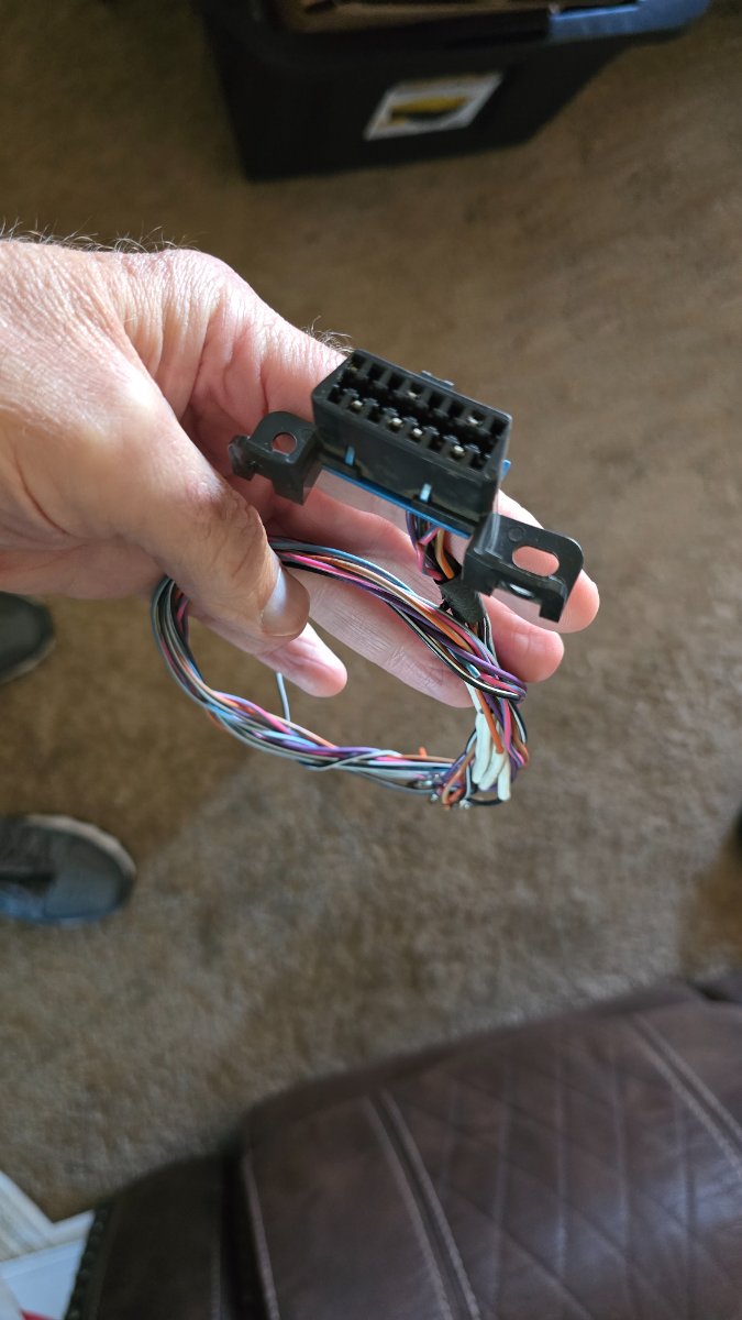

Also, I'm assuming your donor Explorer has an OBDII diagnostic port. You may want to pull that wiring and mount it somewhere in your Bronco for ease of diagnostic troubleshooting in the future.

My ammeter doesn't really do anything the same as it did with the 2.8.
Ranger gauges have never been super accurate however, these are more of a dream at this point but I would like these:

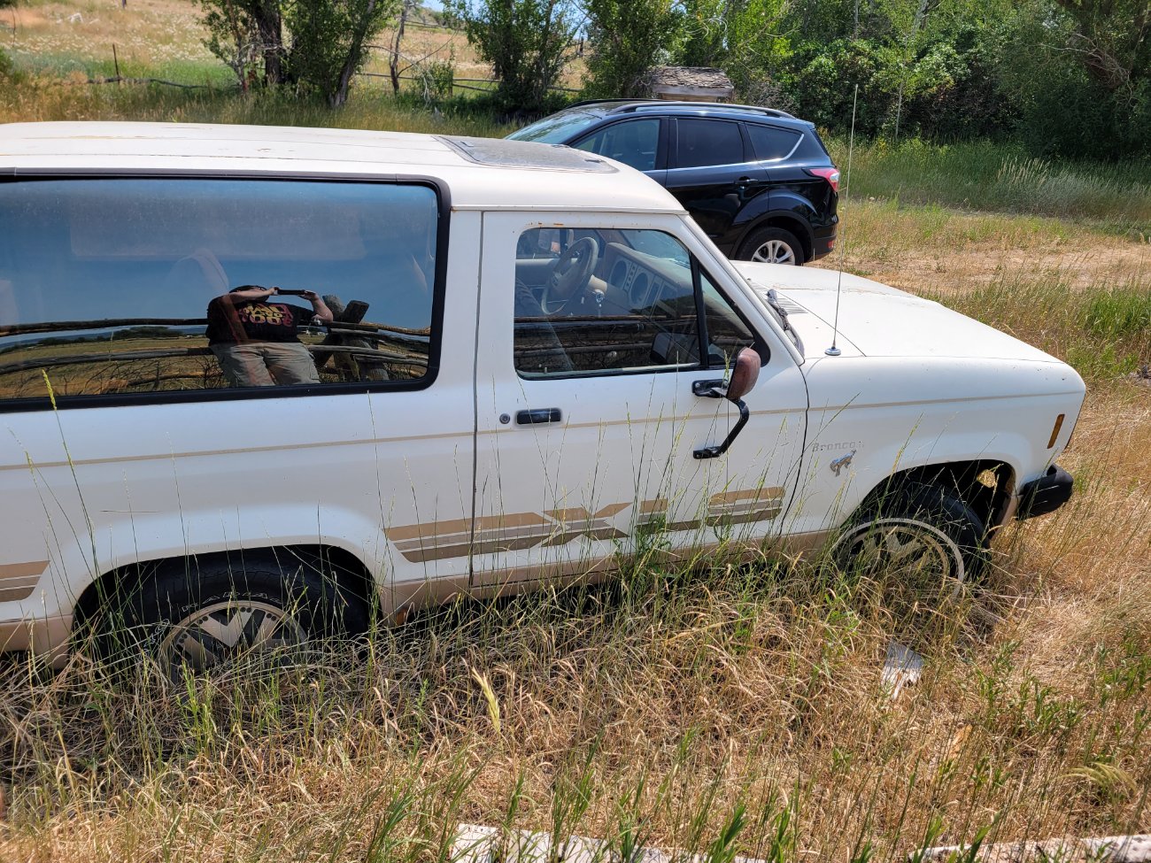

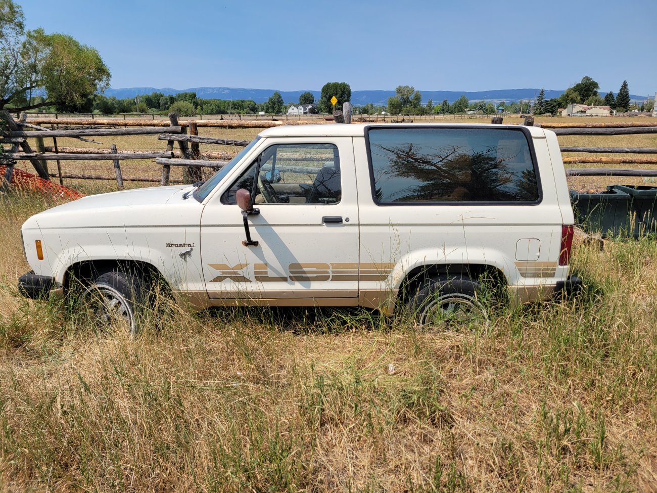

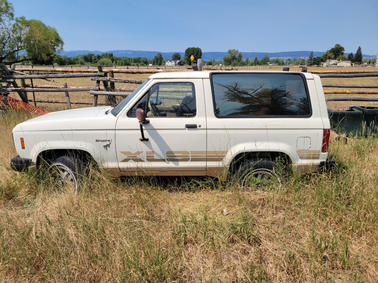

I like that Bronco II. I swear it seems like I never saw an XLS Bronco II anywhere, and suddenly over the last couple of years they've been popping up.
4.0L (OHV) Conversion FAQ's (Read Before Posting)

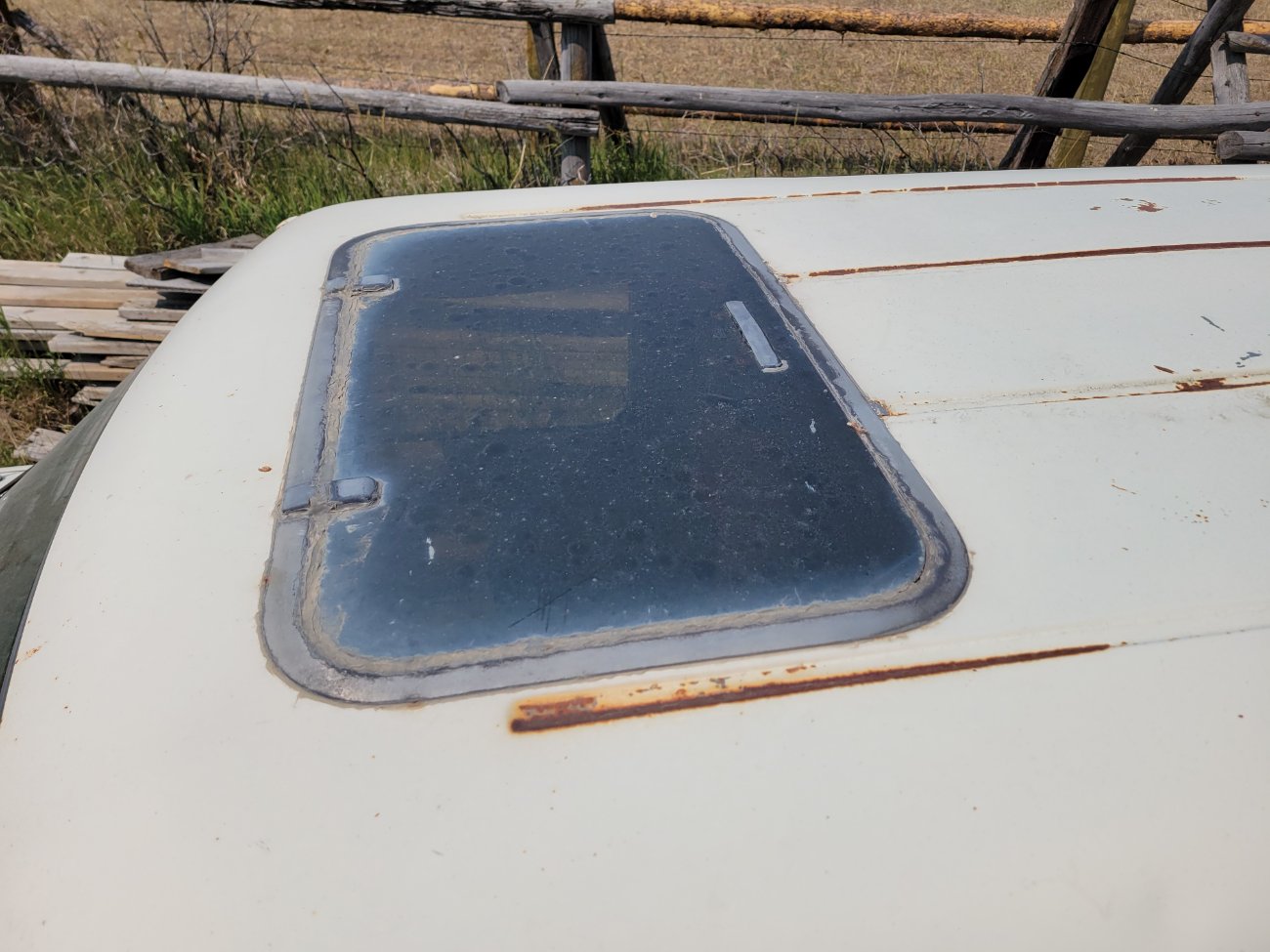

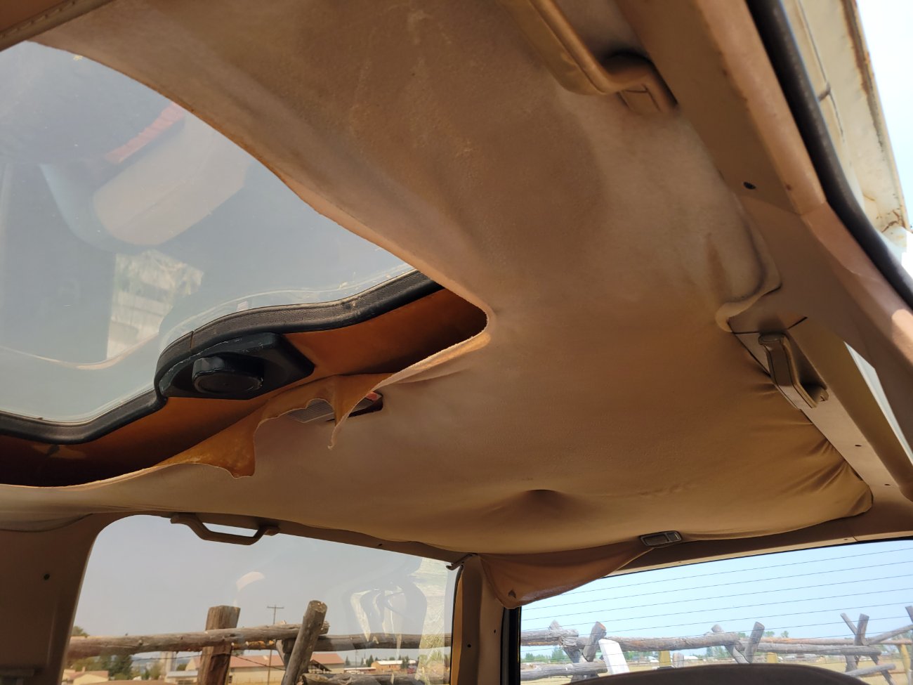

Yeah, mine actually has the manual crank sunroof as well so it apparently is even more rare
The previous owner sealed it up. I assume because it was leaking but I plan on figuring out some sort of gasket so I can actually use it.
