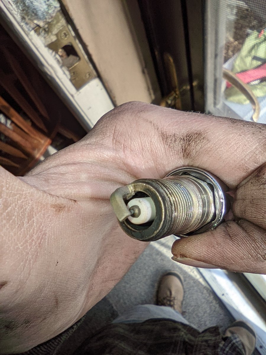

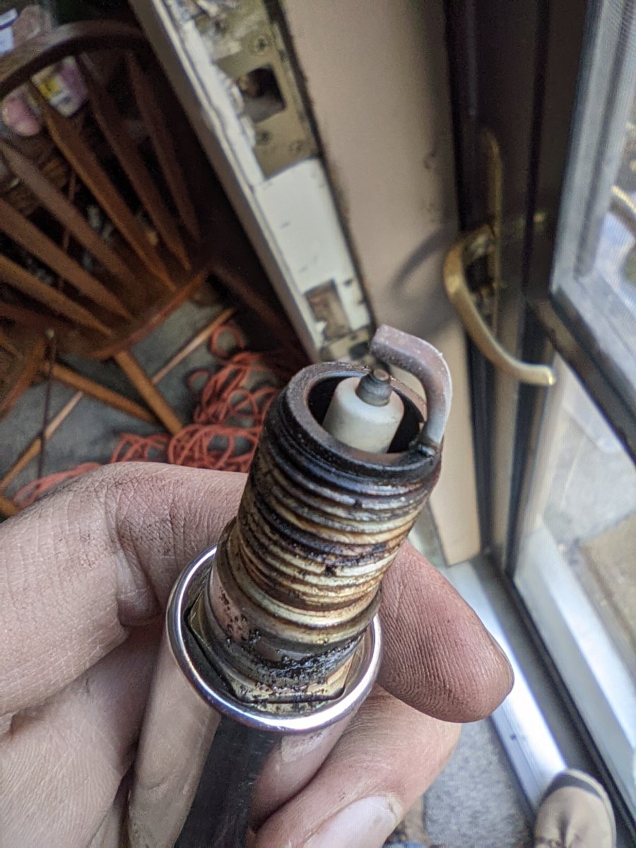

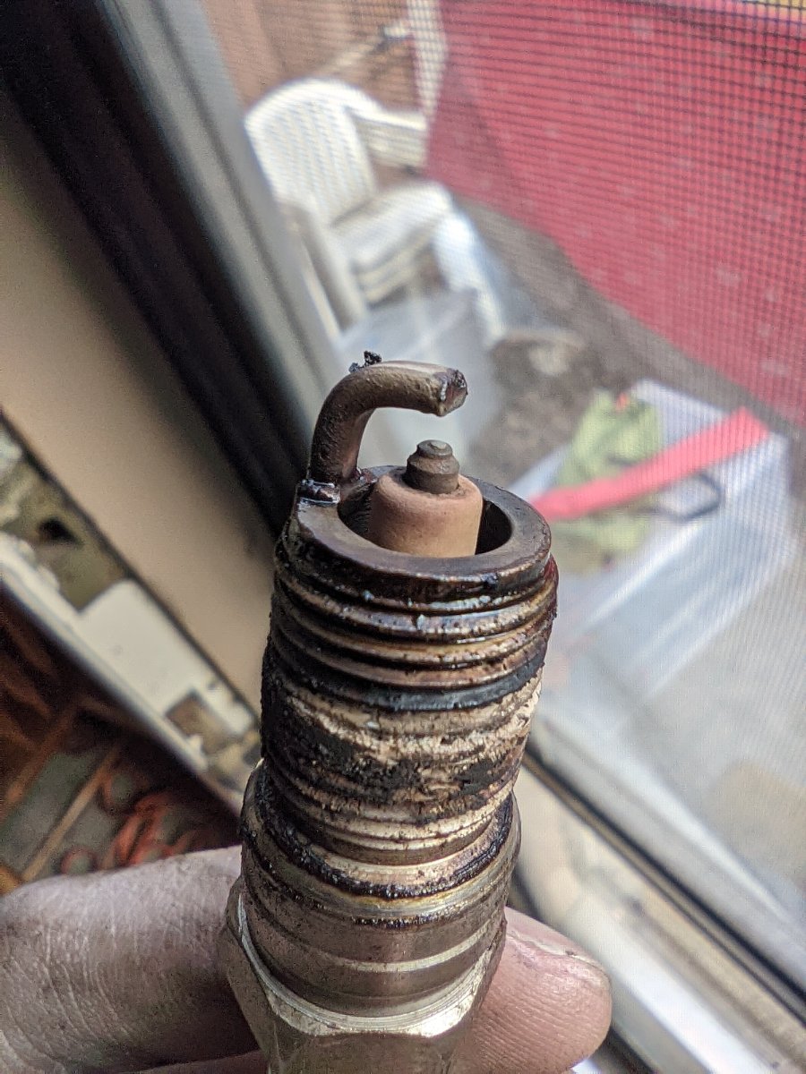

I have driven it 40 or 50 miles since that happened. I’ve been driving it hard trying to make whatever problems it developed become identifiably bad, but aside from sometimes running a little cool from the stuck thermostat nothing unusual has happened. In fact, after I ran about 60 MPH in 3rd gear for a few miles it almost seems like the exhaust is doing a little less of the coughing and the cold dripping than it was before that drive. I haven’t looked at the spark plugs or ran my little camera down the cylinders yet, but I don’t expect to find anything useful. Other than that I’m pretty much out of ideas. It still runs better than it did with the heavily worn copper spark plugs that it had when I bought it, so I don’t want to tear into the engine unless I’m pretty sure that I’ll find something in there. The check engine light has never come on. It's OBD1 and the bulb does work.
So… What should I check or do next? Or should I just replace the thermostat and then wait to see whether anything gets worse?
