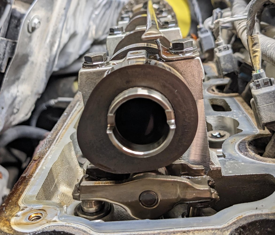

- Before removing any timing sprockets, put the engine in true TDC AND check the cams. I thought I was in TDC, but my cams were 180 degrees off (small section of cam end was up instead of down). Not a huge deal, but the special timing tools for making sure the motor is in sync didn't fit on quite right.
The smaller semi-circle should be at the bottom for the sync tool to fit properly on it, but since my crank key-way is at 12 o'clock and both cams are parallel to the head (like above) the motor is still in sync.

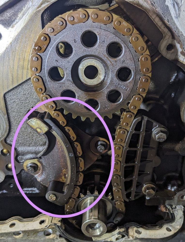

While you are in there, be sure to replace the mechanical timing chain tensioner for the main crankshaft/jackshaft chain. My tensioner was totally broken off. The left and right cassettes were still intact but were getting brittle. I broke one of them when pulling it out.
Are talking about this one?:
4.0 SOHC FoMoCo Re-Man Any Input?  Original 300k engine timing chain noise, time for new engine?
Yeah I got a full kit, so it will definitely get replaced.
