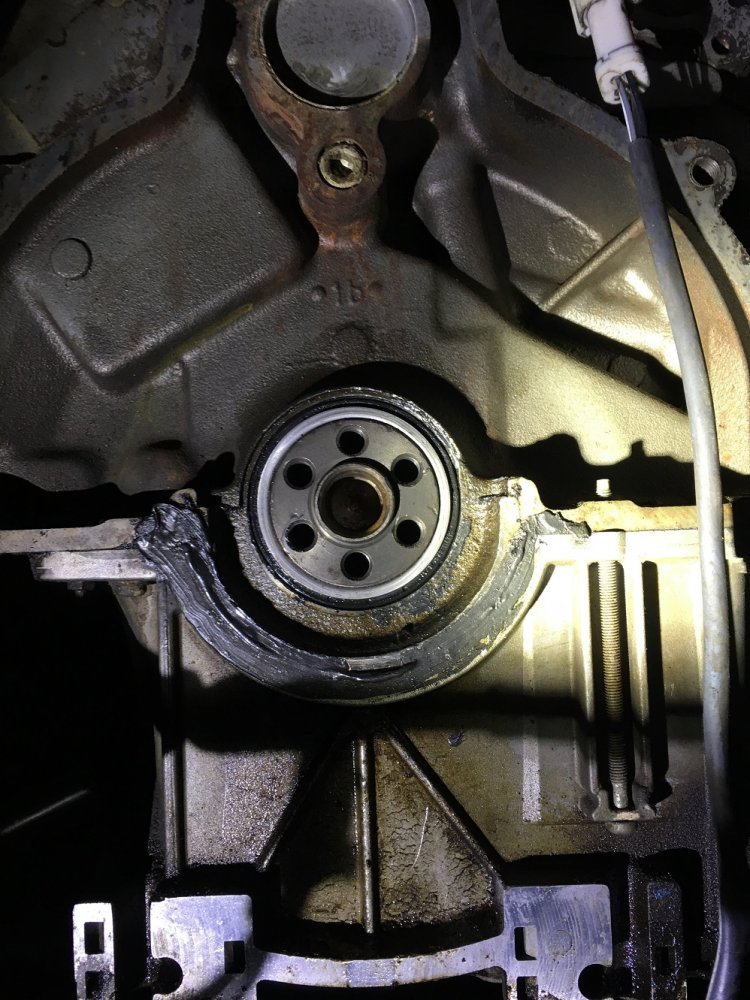

I started to setup to lift the motor and after I took the flex plate off, I noticed a lot of oil around the rear main and also some rust under the top frost plug in the block.
I had the rear-main replaced just last year and am surprised to see it wet around the seal. Is there an upgraded seal available for 4.0 OHV? I think I might also replace
the rear frost plug. Does anyone know the size (metric i assume) or p/n for the large plug?
It also looks like someone put RTV over the plan gasket in the area of the crank probably to address the pan leak. Good think I planned to replace the pan gasket anyway.

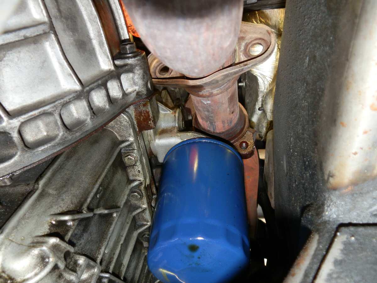

It appears there is a leak from the oil filter housing to the block as well. It's hard to see how the oil filter housing comes off the block. Does anyone have a pic of it?
I expect it has 2-3 bolts and a gasket.

Ever find a pick of where the oil filter housing is?

Last I checked the recommended rear main seal replacement is a ford F5TZ-6701-A which is what it seems yours was resealed with based on the metal ring that you can see.
I'm personally having a leak from the oil filter housing myself that is presenting as a rear main/oil pan leak after those seals were just replaced. Don't forget, if its leaking it has oil in it :D
As for pictures of the oil filter housing there is a pretty well made guide on the explorer forums. I have included one of the many pictures from a post that can be found here: https://www.explorerforum.com/forum...-the-4-0-ohv-oil-filter-adapter-mount.471282/
