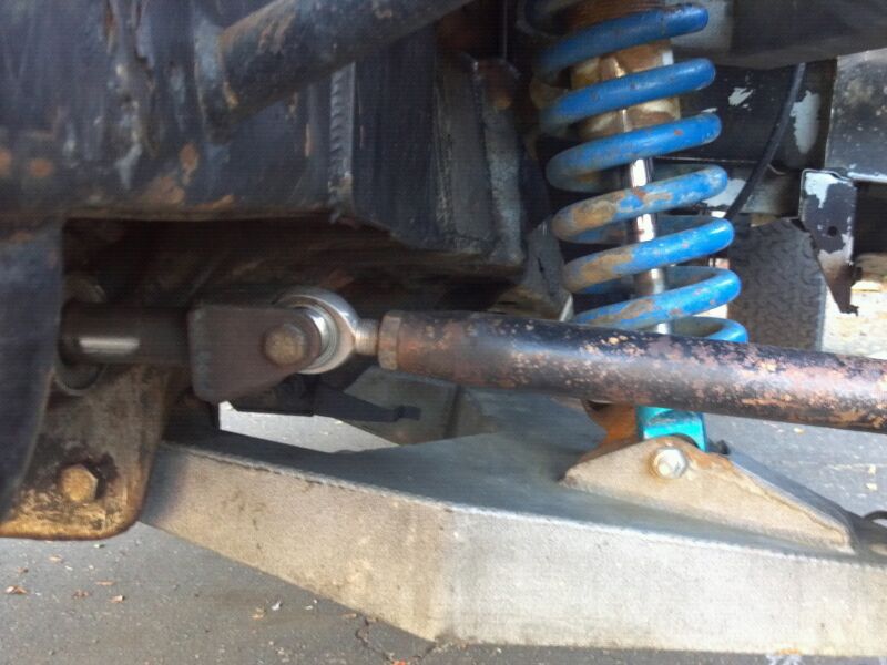

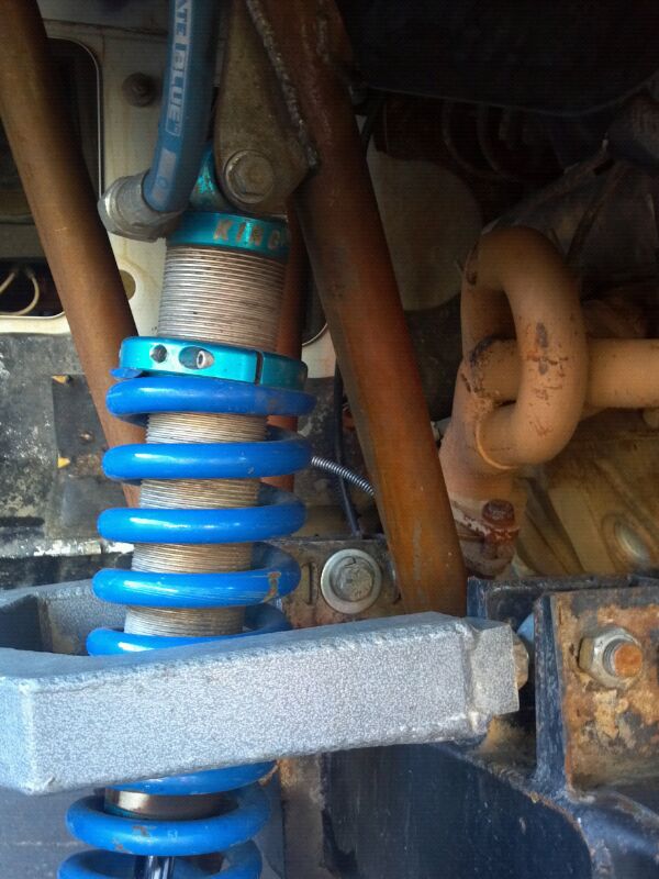

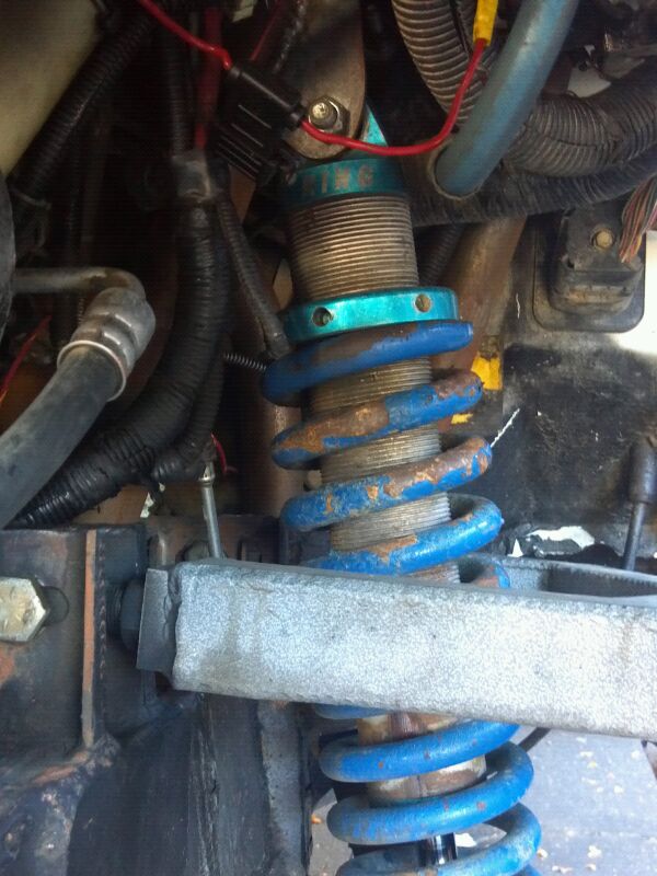

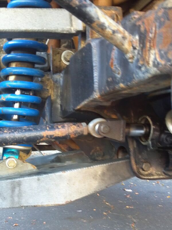

Sorry about taking so long to get the pics guys, Ive been going through some personal issues as of late and it completely slipped my mind. If I can keep my head on straight Ill grab them tonight and try to upload them for you guys on here.
Those are the 4 best shots I've got.

Looking through those attachments I posted, there isnt anywhere to mount a bump stop for the upper arms on it. It kinda looks like you could mount on for the lower arm but I would be concerned about it getting crushed by the coil over at full extension.
Out of curiosity how often have you seen that happen? Ive been around 4 different built LT Rangers both I-Beam and A-Arm and havent seen it happen yet. Also what options are there for a beefier aftermarket steering system?
it depends on how hard you beat the truck up and how old your rack is. usually, the remanufactured racks suck and love to blow up. but eventually no matter what if you have bigger tires or use your truck off road, the rack will start to leak and then have to get replaced. mine leaked for a bit then stopped (hopefully for good). as far as replacements, there isn't much except for going with a full hydraulic set up from some company like howe. the admin of DR has a hydro steering set up on his ranger with a camburg race LT kit and it's pretty bitching
