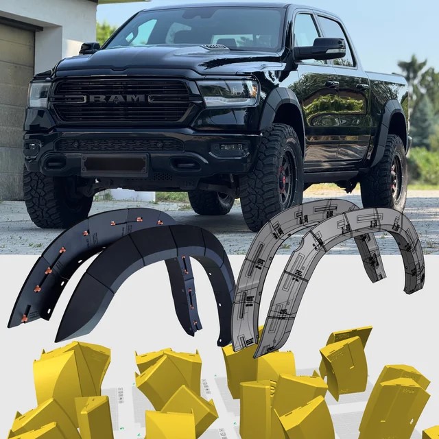

So I came across this on reddit.
It would be cool if we could do something like this for the different years of Rangers, especially the ones where you can no longer get fender flares.

All the seams... Not real aesthetic IMO. A big ass printer that could spit em out in one piece would be cool though.

If the parts fit together well enough, seams could be removed by finishing in place. Thinking sanding and epoxy. It would be more work for sure...

That is where 3D printing comes in good for making parts like those flares. Making prototypes, not finished products. Create a multi piece prototype using a 3D printer, test and tweak. Once satisfied with the product, assemble and smooth the prints, then use the prints to create forms for fiberglass. Heck for that matter you could use them to make molds for that flexible stuff that they use for making GFX or body kits.
While you could use the prints directly, I probably wouldn't recommend it unless you had a printer large enough to make them one piece like @Blmpkn said. Even then, I'd only try it with a filament that is somewhat flexable, heat resistant, and UV stable. Even stuff that claims to be flexible is still going to be succeptable to layer separation under the right conditions. Adding seams from printing multiple smaller pieces is only going ot make it worse.
