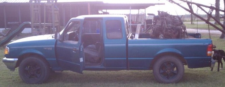

You think that truck EFI intake is going to fit under the hood of a Ranger??
Hmm, good point, unless a body lift is involved...

This is a pic of the motor and trans in the back of the truck, with all that EFI crap still on it... I must agree that it would be a bit hard to close the hood if i left all that stuff on :icon_rofl:

  • 351w with AOD swap question.
