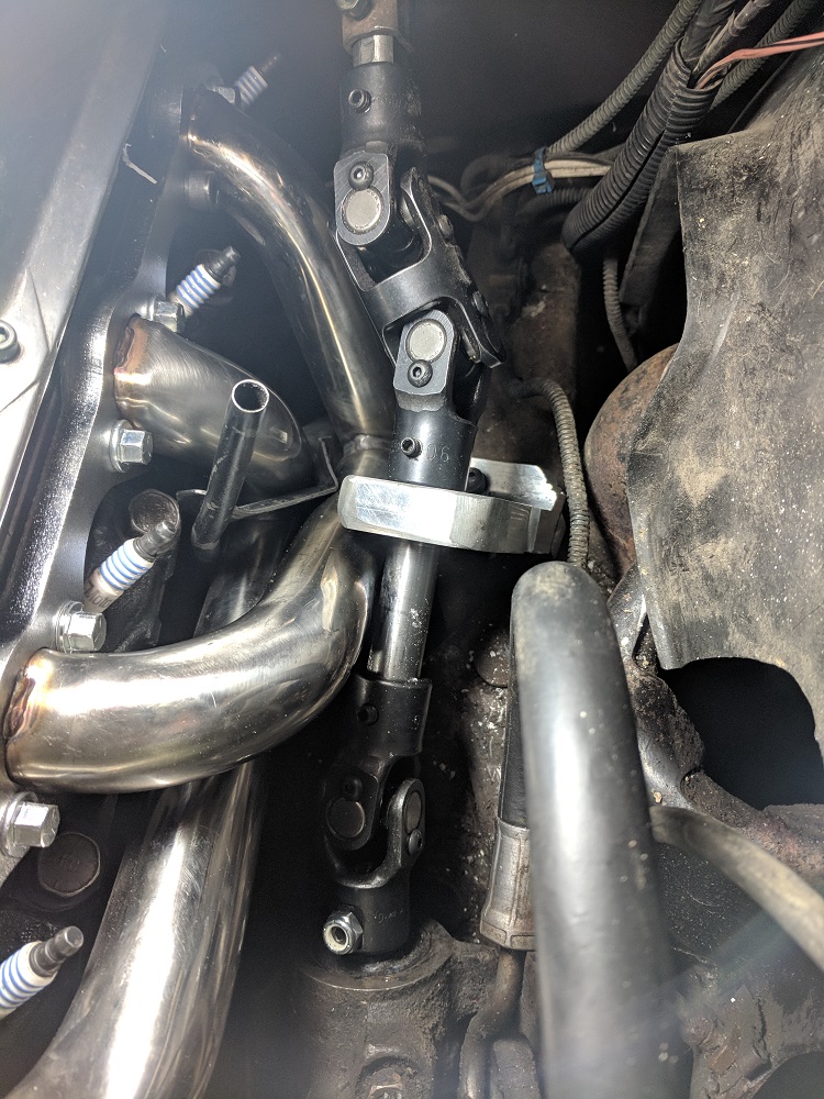

Got the motor in and installed headers...had to notch the frame on passenger side and need to do some rework on the header where the collector flange is as it is up against the pan rail of the AOD transmission....drivers side went right in but have a major issue with the steering shaft....need to move the one header pipe in about an inch so it clears the shaft..

We have the tri y headers mounted...had to notch frame on passenger side and the driver side we are going to have to do some major mod's to the steering shaft to clear the headers....also since we have an AOD in it the header flanges are up against the pan rail of transmission, but we think a little heat and tweak and we will be good to go.. Had to pull heater A/C box completely out due to hardly any room at the fire wall since we have elderbrock aluminum valve covers on it, we had already modified the air box to fit the 302 in there...Trying to find an A/C delete heater box now...
Here is how we dealt with the steering shaft issue...

What parts did you use for the steering shaft?
