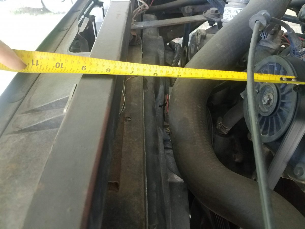

302 rad/cooling pics/ideas
when i wake up tomorrow....i will have to finish a project for my nephew. i will try to take a pic of my truck and it will be easier to understand my stupid...
its still dark when i get in from work and i am out of beer....so it will have to wait till i wake up:thefinger:
No big hurry, I am probably not going to try to crack the A/C nut until next spring.
i took pics with phone....not working to puter.
did not forget.

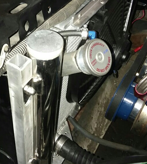

Hey all, I know this is an older thread, but instead of making new one, just carry on here.
I have the Northern 205138 rad for my swap. I am having troubles finding a proper fitting rad cap for this. as this rad seems to be a touch thicker in the screw down part. what have you had luck with and how many pounds are you running? I am thinking 13-15 should be fine.
cheers thanks
cheers thanks
I have the exact same radiator. A standard radiator cap from any parts store will work. It's just a tight fit. Northern suggests a 20-22 lb cap, but I'm using a 16 lb cap on mine.
thanks insane.... yes it is a tight fit, here i was thinking it was just me not pushing hard enough.... cheers !!
