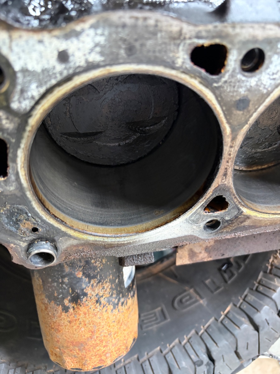

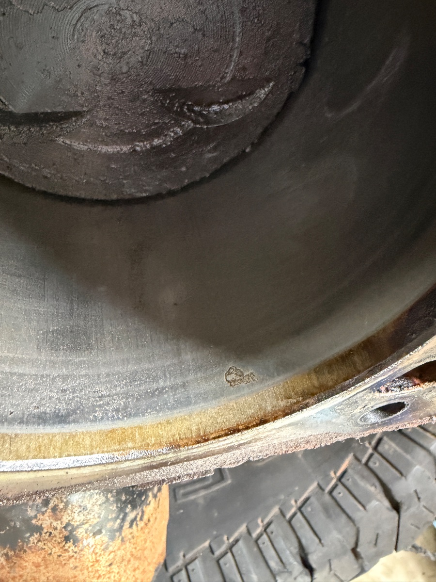

Hi Everyone,
Prepping for a 302 swap into my 94 Ranger Splash. Over the weekend, I cracked open the long block I bought and saw this. Anyone with more experience than me know if this is runnable?
I bought GT40p heads, reusable ARP head bolts, and fel pro head gaskets. My current plan is to torque the new heads down and run a compression test with lubricated cylinder walls. I am okay with burning some oil, but is this a loss? Should I just buy a new short block? Maybe bore this out?

Is that a pit that you can catch your fingernail on or just discoloration? That close to the top I would be tempted to just run it if it's not deep or an actual hole. If it's discoloration I'd just run it and not even think about it.
Doesn't look like there is much cross hatch left in the cylinder walls, if any. Guessing that engine has some miles on it for sure. If it runs good, who cares. I am sure a machine shop would want to bore it a bit. Necessary to have a good running engine though? Probably not.
The amount of time the piston rings will be over that spot is negligible. I'd run it.
I wouldn't worry about it unless it's deep. I took a layer of built up carbon off all the cylinder walls of my 4.0 that was about that far down with a scotch-brite pad. Granted the 302 is probably different...
Polish it up a little with some fine sandpaper and wipe it down with an oily rag if it bothers you.
Before I put better heads on it I would pull the pistons, hone the cylinders and replace the rings and bearings.

Many years back, we would dismantle and run a hone down each cylinder to clean them up and restore the cross hatch.

I wouldn't go through all the work and expense of an engine swap without rebuilding it first. I hate doing the same job over again.

I am with Walt on this - pull the pistons, hone the bores at least, put new rings and bearings in it at a minimum.
I could go either way, being me I would do a dingle ball hone, rings and bearings but to me that's simple... as far as the rust pit this post is about I don't think I would worry about that though... DNJ bearings and rings aren't too expensive though plus a harbor freight hone and a can of WD40 and a few cans of brake clean and you would have everything to freshen it up... I wouldn't go through the trouble of taking it to a machine shop to get bored, new pistons and the whole 9 yards though unless you expect to drive the thing for a couple hundred thousand miles or something...
