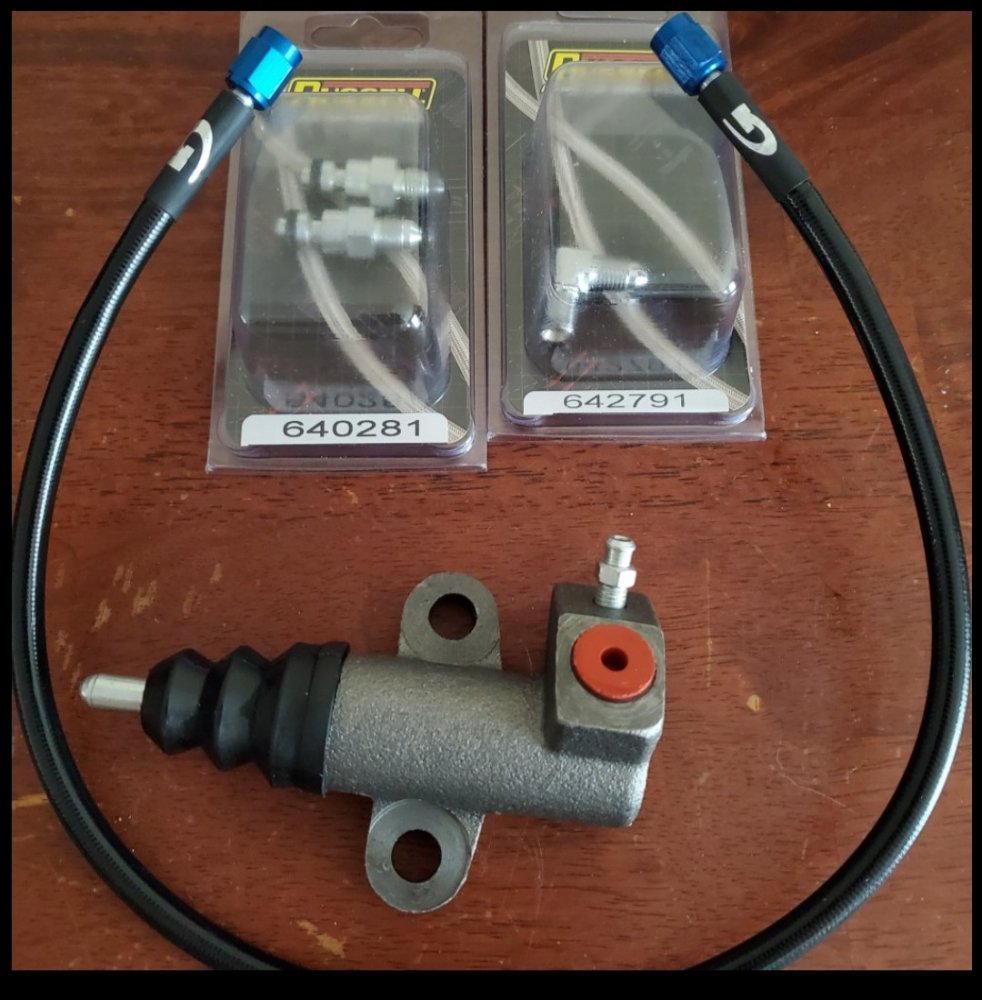

Hydraulics for the t5....
1980(ish) 280 z slave. They say a 92 ford turbo probe slave works better.
2000 f550 clutch master. It does NOT just click in the bracket. The bracket has to be widened
