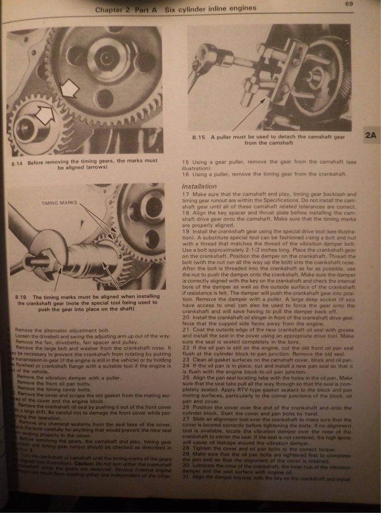

The timing gear was on the crank
I had to go look, still have a Ford Van manual 69-91. Not sure what I'm doing with a 91, I was in Tennessee in 91 and the van was in Oklahoma. I moved back in 2007 and it was gone, guess I could have reported it stolen.
I may have got the book at a yard sale or Goodwill or something.
Yeah, I went to look at a picture, it had been so long, I only replaced mine once, not really sure exactly what I did then
