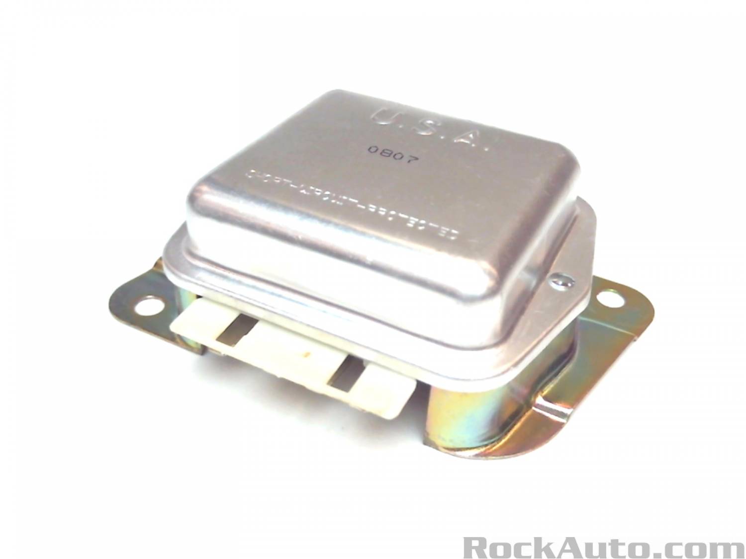

stole this from rock auto....
attachment.php
if this is what you have...check and clean all connections.

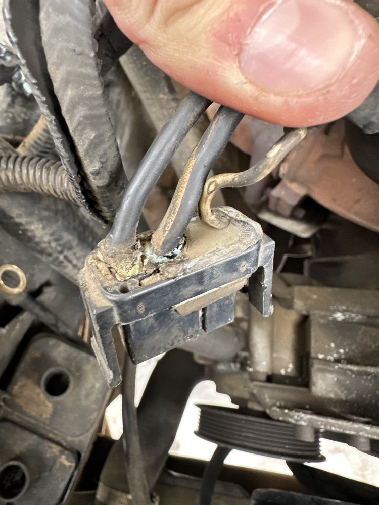

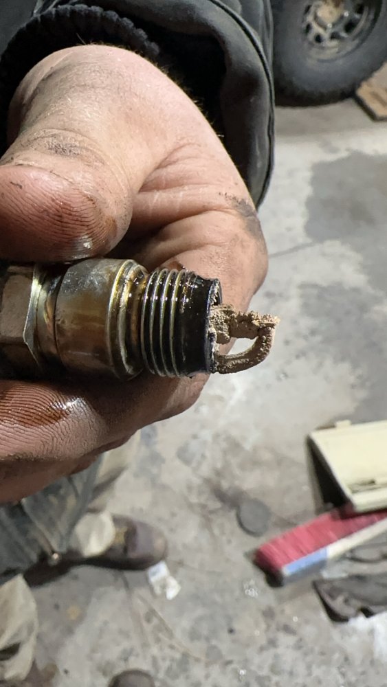

Well I figured out the a few problems and fixed/temporarily fixed them the first one was the ground cable came loose from where i mounted it and it fell on the exhaust and melted the insulation into the wire causing it to not have enough flow and I also replaced the screwy 3 wire plug on the alternator (in the first picture) and that solved my problem of it running worse the more electrical I turned on but it was still running bad I looked and looked and figured might as well check spark plugs even though I replaced them about a month ago and they were all corroded (in the second picture) and I did some research and I’m sure all or you see that and immediately know why it’s like that but i found to be caused by very advanced timing so I checked with a light and it’s about as far advanced as one could make it go so I’m gonna turn the distributor back and put new plugs in and hopefully I won’t have this problem any more
