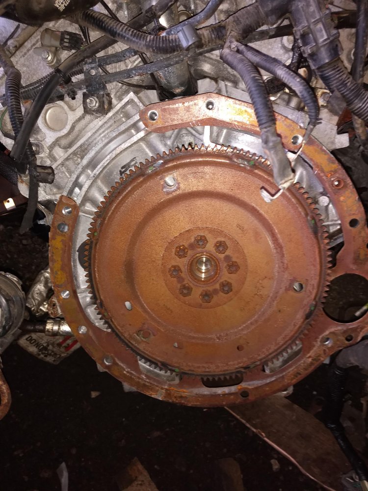

I dont remember it ...the taurus v8 as a Vulcan pattern. But as duratech v6 which I think has 2 patterns. They were cast at Windsor....sent to Japan...and sent back with suicidal cam gears and valvetrain.
The intech v8 iirc....was the same bolt pattern...the bigger of the two. Some duratech engines had two patterns...now I need to dig that shit up...

That's what I was saying. The duratech 6 has two patterns I have seen. The L is seperate from those. I did not verify the intech as the larger pattern .
Most of those engines do not have seperator plates.
I have the cyclones as well. I will dig out the others when I get home.

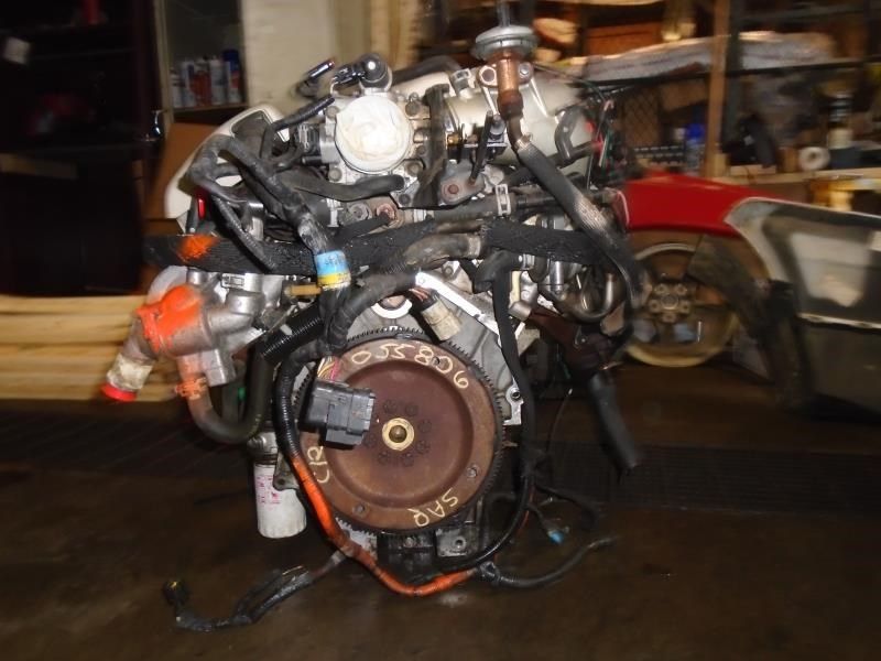

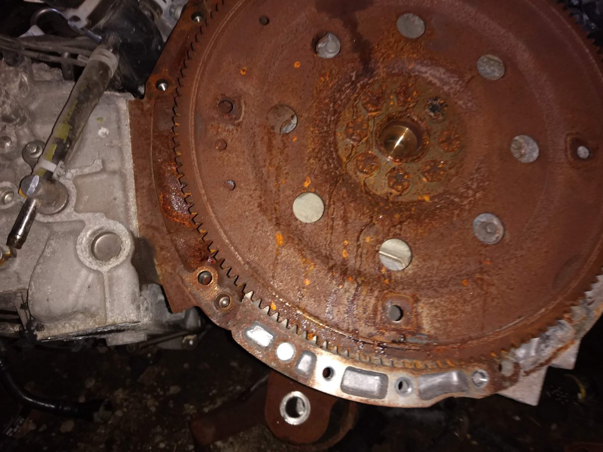

2.7 rwd nano plate on 3.5 front drive engine.
Rear drive cyclone.
I wish I could find pictures of the 3.4 v8 bellhousing pattern.

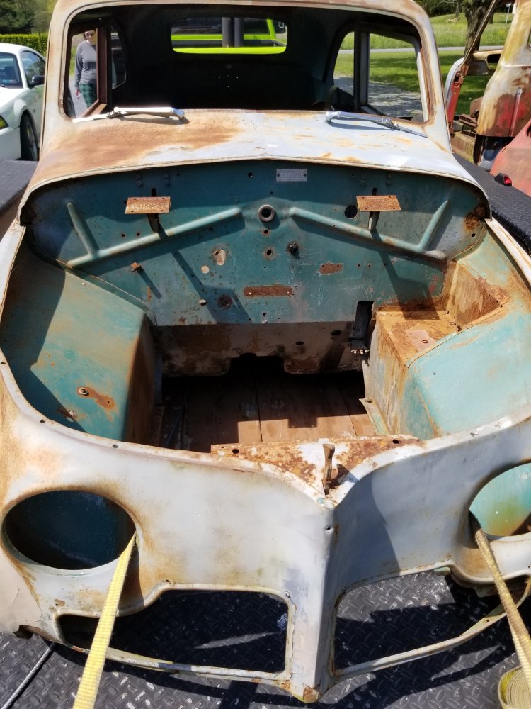

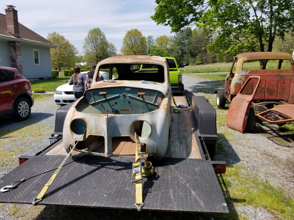

Frame is split. They really are not worth much anyway. It's kinda like a Studebaker they are more rare than the Ford and Chevy of their time and they were setting al sorts of records but a restored studebaker is worth significantly less than a restored ford or Chevy.
Do you know where to get an original motor for a 47 Crosely?
Lol good luck.... 22hp cobra motor.
But I think they had the first overhead cam and air conditioning.
