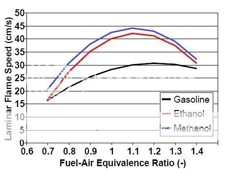

E85 actually has a faster laminar flame speed than gasoline. It's slightly harder to ignite, but burns faster once lit.

Wrong. Google "octane" then check the octane rating of E-85. You will soon see you are not correct.
Jason--
E-85 has 105 octane. It also has a faster flame speed than gasoline, this is a well known fact.
Here ya go--
