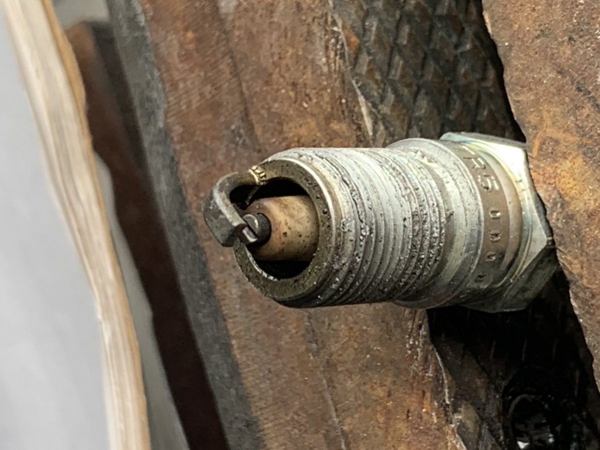

Is number 5 plug wet after running it a little while? If it's not firing and the plug is wet, then you can be reasonably assured that it's getting fuel. If it's dry, it's either firing or not getting fuel. Any possibility of a plugged intake port? Maybe an errant shop towel or something? Fact is, if the other cylinders are firing and you have compression and ignition, the only thing missing is fuel. That said, I have seen coils that would spark outside of the cylinder but not produce enough spark under compression to ignite the mixture. I'm not one to throw parts at a problem, but for the price of a coil, it might be worth a shot.

I guess it’s wet, but it’s not dripping wet. This is a close up pic taken right after removing the plug from #

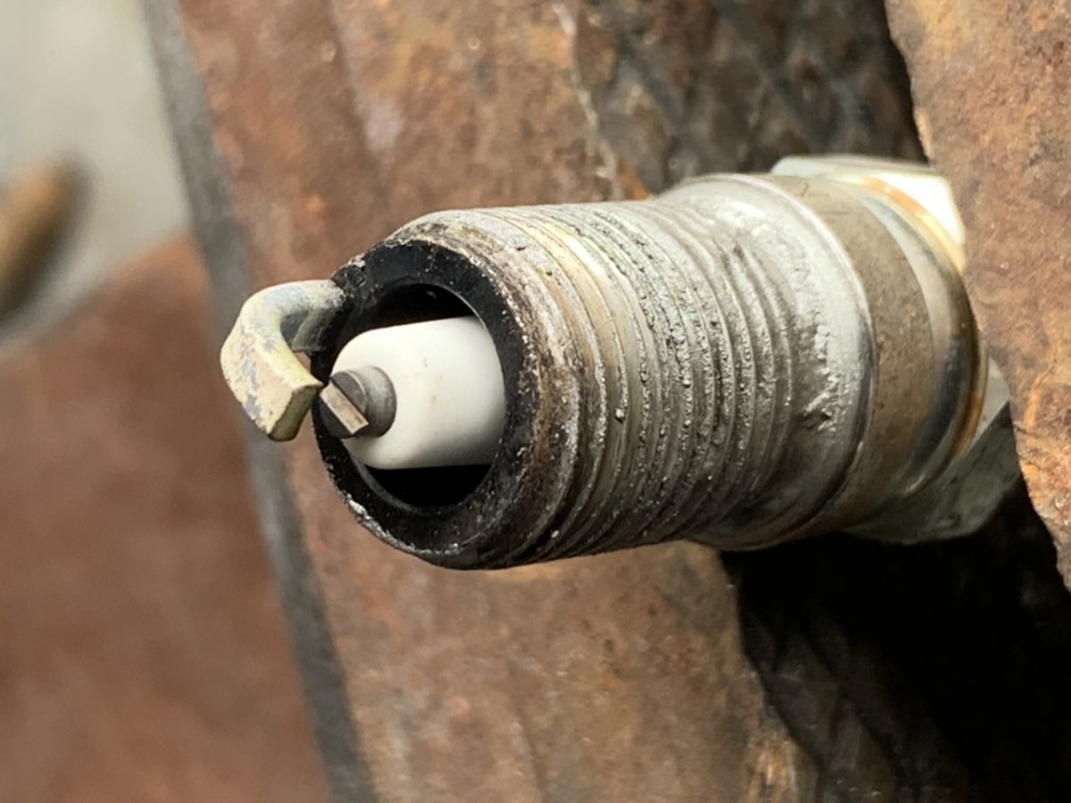

Here’s a pic of the #1 plug. Looks a lot better to me.

The coil pack can fail of course, but since you swapped outputs at the coil and the problem stayed with the cylinder it's hard to see how that could be it. Somehow having a short at the plug would do it, but how could that happen with two different plugs - unless it's oil fouled or something? I gotta say, that #5 plug is dirty and looks like it has been firing something! If it was a new plug and never fired it should be wet and a little gross, but not dirty like that.
So I guess I have been thinking it was not firing at all, but your title does say misfire. Then it has compression, fuel, air and spark but it's burning poorly? Oil in the combustion chamber fouling the plug?
Plug looks oily to me. Could have a little fuel too but it doesn't really look like it hasn't been firing.
