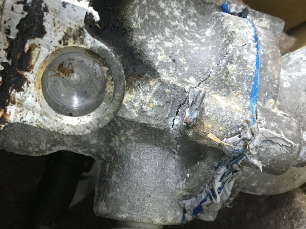

Got my intake in to start porting it and BOOM it's cracked. So now I wait again.
The seller refunded me on the intake, turns out it was wrong so the crack was a blessing. I did overheat again at idle with AC on. I pulled the front off the truck and washed all the bugs and rocks out of the AC coil and radiator. I also installed a 180* stat. I have not had another issue not even close.
