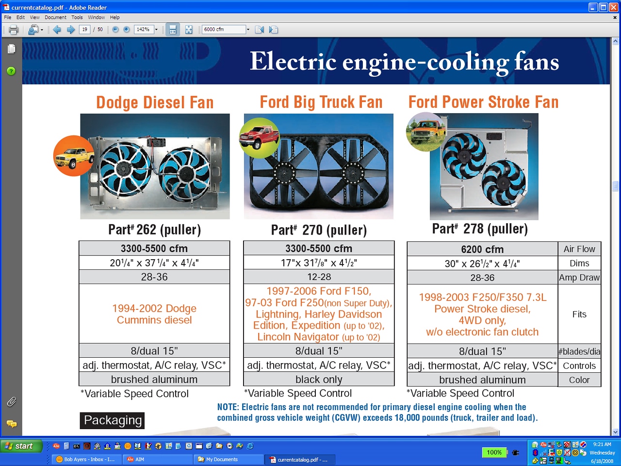

In addition to the e-fan not making much difference:
1) They don't have the cooling capacity of the mechanical fan/clutch
2) They are way less reliable than the mechanical fan/clutch due to all the components:

Even Flex-a-lite recommends the mechanical fan/clutch over their 6200cfm e-fan for heavy towing with diesels!!!
That is a diesel you mook! They also run 15W-40 oil, does that mean you should throw that in your gasoline engine?!? You yourself just dimed out your statement with "heavy towing with diesels" since that is a totally different scenario. Those engines can use the power to turn bigger fans better as a benefit.
Just proving a point, e-fans don't have the cooling capacity of a mechical fan/clutch!!:icon_confused:
Matter of fact, here is another statement from Flex-a-lite, proving an e-fan doesn't have the capacity of a mechanical fan!!!
"NOTE: Flex-a-lite does not recommend using
an electric fan for the primary cooling source on
4-core radiators. Flex-a-lite recommends at least
60% of the finned core area be covered by an
electric fan/shroud assembly for optimum cooling."
