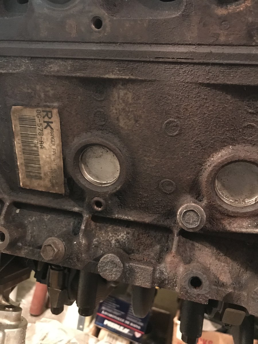

CAN ANYBODY TELL ME IF A 1999 3,0 RANGER HAS A COOLANT DRAIN PLUG IN THE BLOCK & IF SO,,WHERE TO FIND IT !
this is the passenger side. driver side is closer to the front, behind the motor mount.
the plug directly below the freeze plug.
they can be quite difficult to remove due to rust.

SO THERE IS 1 ON EACH SIDE ? I FLUSHED THE SYSTEM BECAUSE IT NEEDED IT,I USED PRESTONE ENGINE FLUSH & I THINK I HAVE A CLOG,ALL WAS FINE PRIOR TO FLUSHING,NOW I HAVE PRESSURE THAT BLOWS THE CAP OFF THE OVERFLOW RESERVOIR & BLEW A HEAD GASKET,A FRIEND SAID HIS COUSIN USES CLR TO FLUSH ALL HIS VEHICLES & IT SUPPOSEDLY WORKS VERY WELL,,OFF W.CENTRAL NEAR COLLINGWOOD IS MY LOCATION & YOURS ? ANY SUGGESTIONS WOULD BE GREATLY APPRECIATED !
yes, one drain on each side.

Is that drain plug hex, torx, er whut? :unsure:
mine are allen hex. I'm not sure what was originally in there. may have been a square head???
tapered pipe thread for sure.
