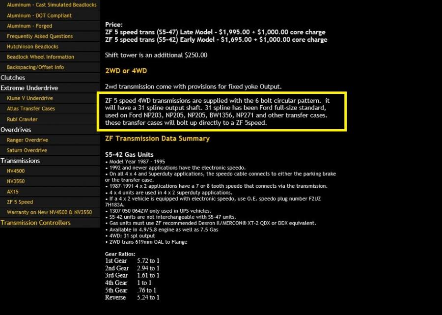

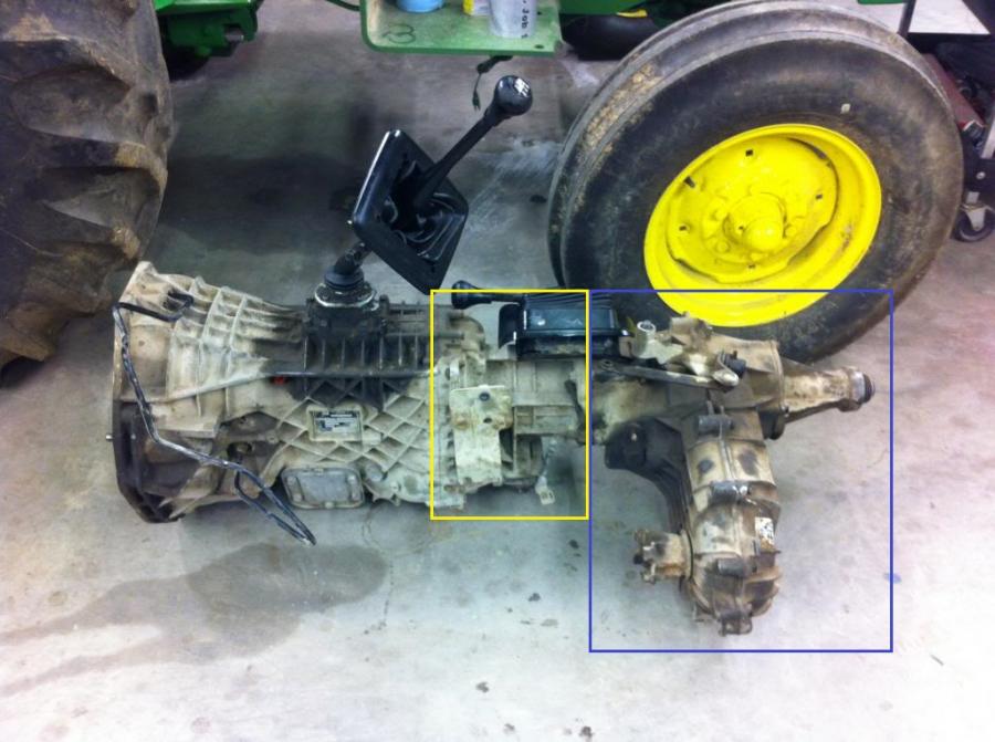

Hi, I have a ZF S5-42 behind my 302 in my 1988 ranger and I bought some 4x4 axles....a 9" and a DANA 44, my question is while searching for a transfer case and tail housing/shaft for said transfer case, is there any difference in splines and mounting or are they all same "
I have a identical ZF S5-42 Small bell housing in pic, but its a 2wd tranny and I'm wanting to make sure I find the right tail housing and shaft that will mate up to a transfer case.... basically I guess I need to know which transfer case's will bolt up to the ZF trans...

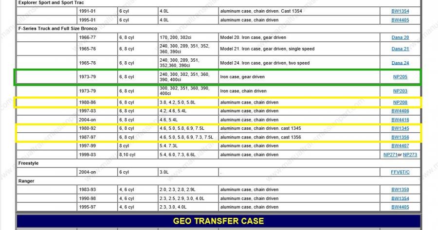

updated info
I've found some info but still limited to actual knowledge of fitment
I know if I had a NP205 they are unmarried and can be mounted anywhere, but the NP208 I think is common manual lever and the BW transfer cases are electric shift but not sure

I found my answer, all the same :headbang:
6 bolt 31 spline. so I think I may use a np271 electric shift.. and I just need to scrounge a output shaft and a tail housing for my tranny
