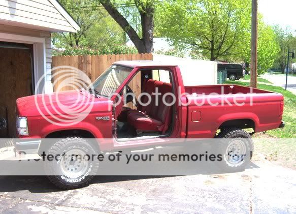

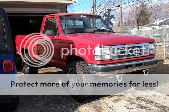

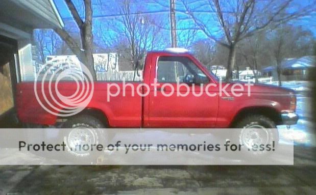

i did about what your looking at. i had spacers then decided to go with leveing coils. now im running leveing coils, 1.25" steal spacers i made at work with longer i beam bolts, in the rear im running leafs that came on my 94, and i have a 3" body lift. swapped in an 8.8 with 4:56s and a lockright on my 2.3 5spd drivetrain. some times i still think i could push it up hills better than drive it hahaha. im runnin 31s that hit the rear of the fenders a few times jumping it at the dunes. but im still happy with it its a 2wd 4cyl that made it everywhere at silver lake besides test hill. heres some pics to give you an idea. and this is with leveling coils and 1/2 spacer and a rotted core support, now with bigger spacer and reconstructed core support the front is about level with the rear.
