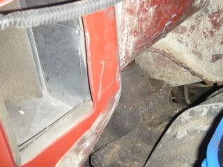

Oh, okay. I didn't know that you had bent/loose bolts on the bodylift. When I said that you would be hanging the weight from the front of the motor, I am referring to having to lift the motor/tranny combo by the front end of the motor to be able to get the tranny to clear the radius arm mount crossmember, even with the tranny adapter removed it is still a tight fit.
Here are a couple of pix,to give you an idea of the lack of room:

Now, with a B/L, you will have extra space, of course, but it will still be close, I'd say.

Well, with the radius arm Xmember gone, that DEFFINATELY makes things easier. Now, you can do it like a normal swap. I would, however, at least mount the bellhousing on the block to aid in locating the motor, front/rear. Oh, and maybe take a hard look at the pinch seam right above the top of the tranny, just to make sure that it will clear...
Oh, and as for trying to install the tranny from under, on my truck anyhow, I had NO room to get the T-18 over the Xmember, into the bell, and still keep a jack under it. The Xcase is not that hard to do, along with the adapter.
