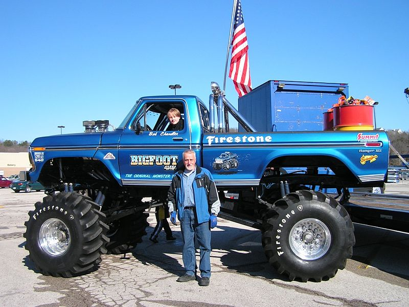

I wonder if Bob Chandler ever took his truck back to the dealership for vibration issues? :not_i:
