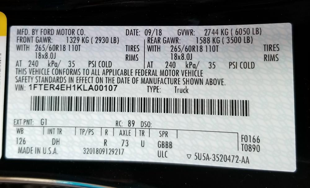

Although, could we trouble you/fastpakr to note SCab or SCrew/ 2wd or 4WD against the Federal stickers? I don't have my secret decoder quite set up yet & they are much more similar than our older Ranger.
Again, thank in advance
The one I posted was from this 4-door:
attachment.php

I'll take an initial crack at the VIN decoding:
1ft - Ford Motor Company USA | Ford | Truck
e - 6,001-7,000 gvwr - all are 6,050lbs gvwr
r - Ranger
1 - SuperCab; 4 - SuperCrew
e - 4x2; f - 4x4
h - 2.3 EcoBoost
4 - Check digit
k - 2019
l - Michigan Assembly: Wayne, Michigan
a000xxx - sequence number
historic Rangers had 1 for 2 dr SCab, 4 for the 4dr; e was the 2wd, f was the 4wd.
Which would suggest 048 was a 4x4.
I suspect 4 spring packs - gaaa was on the 4x2 SCab, gbbb was on the 4x2 SCrew, hddd was on the 4x4 SCab, missing is hccc for the 4x4 SCrew.
I'm also noticing the DSO (District Sales Order) is left blank. That also tells me it's a pre-production truck never intended to see private hands.
When are they scheduled to be in dealers? Last I heard was February or March of '19. If they're starting production within the next 2-4 weeks, they could land sooner than that. Ford's website still has it listed as a future vehicle though.
I believe the only time there is a DSO is when it's a special order. The DSO will show the location it was ordered from.
